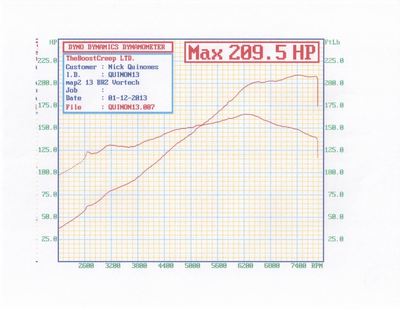

First off let me give those of you a short summary of my kit and mods. The only mods I have beside the supercharger is PERRIN catback non-resonated, non-catted front pipe, and over pipe I have their oil cooler and air to oil separator. I received my kit in December of last year. I had PERRIN’S so for the first couple of months had a lot of different maps that mad great power and was happy with. But it just wasn’t enough being at such high altitude I didn’t see the same numbers a lot of you are with their tune. Here’s the dyno chart just for a refresher.

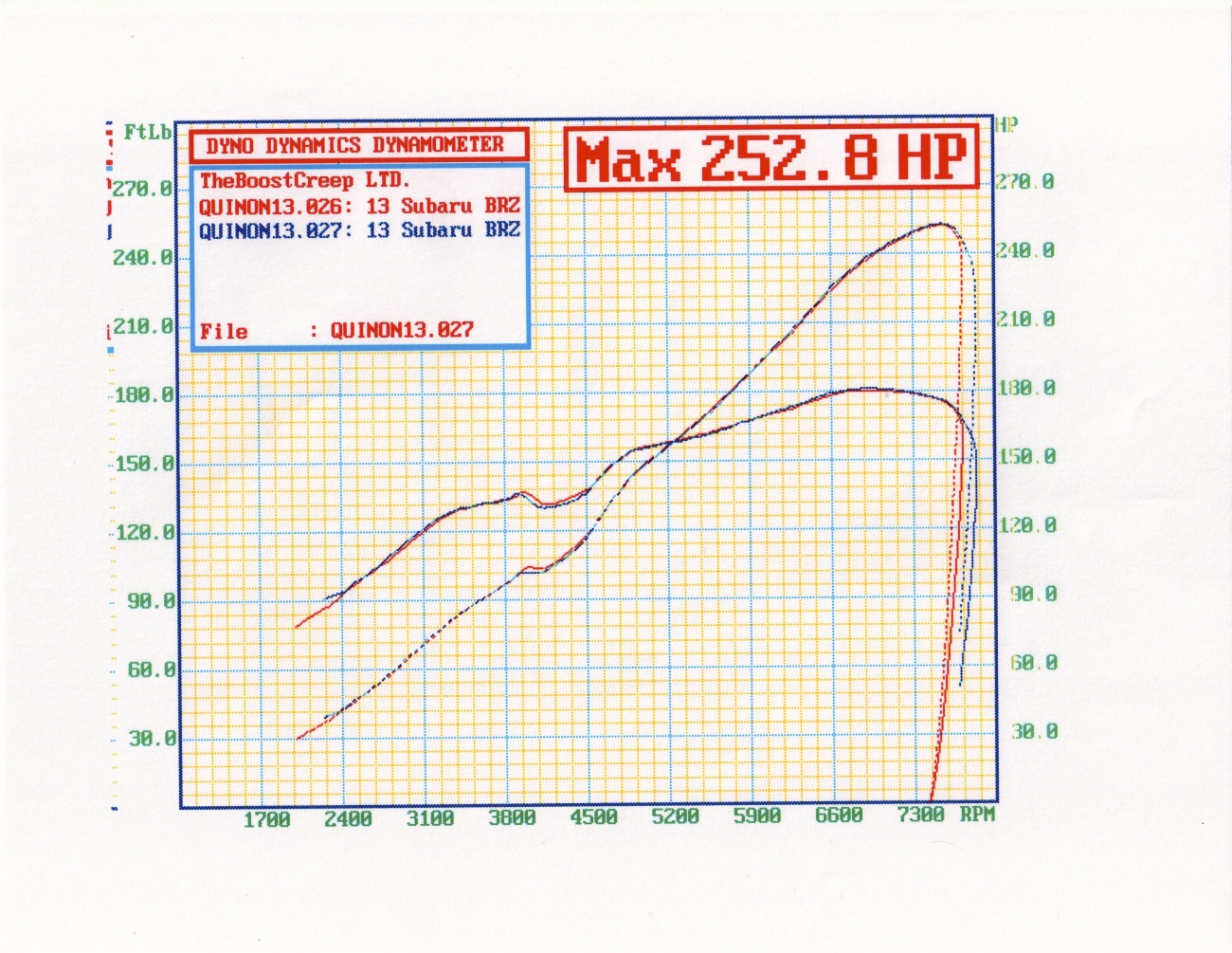

After running their tune I decide to go in my own direction with this kit. In order to run E-85 I went with Visconti’s 500cc fuel injectors and fuel pump. Also had a smaller pulley ship to me from Vortech. The smaller pulley didn’t make very much boost from the old one maybe .5 a lb. but the E-85 made good power with the kit. I thought this was it, didn’t think there was going to be anymore power come from this kit with out a compressor upgrade and some internal work to the engine.

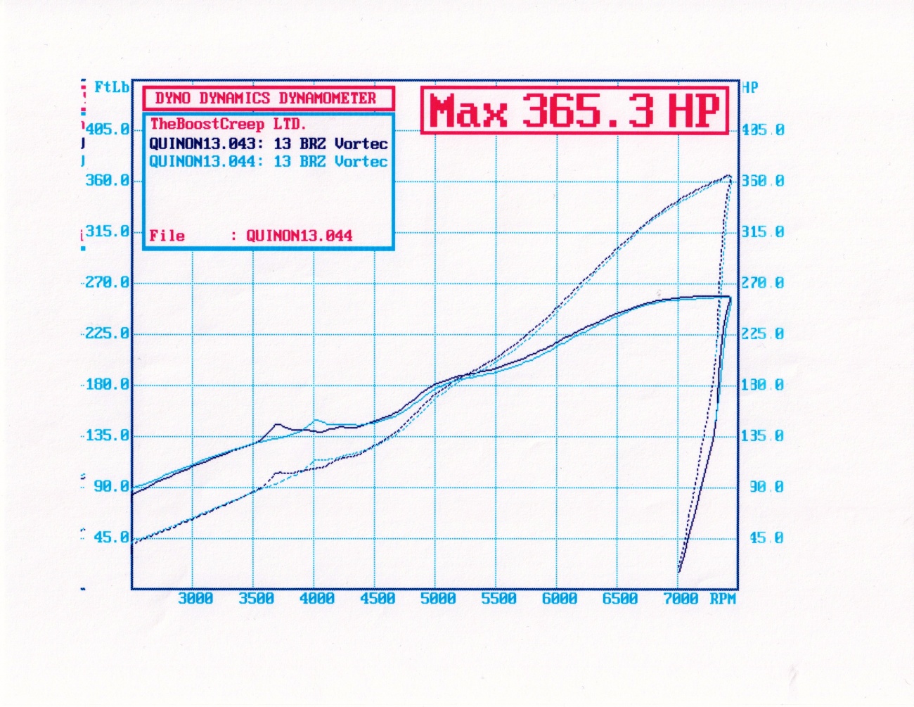

Coming into this I was expecting to be around 290-300hp maybe 200-210tq. Went to do the first pull and the car went lean at about 5500 rpms. Wish I had got these charts printed. But at 5500 the car made 250hp and 180tq. It took awhile to get the AFR right after a lot of tuning he finally got it right where we wanted it I can say I am very impressed with what Vortech. Once again it’s like a whole new car. The car made 365hp and 261tq with the rev limit being set at 7450rpms. It made 12.5 lb of boost. Now this is what I was looking for. I found myself asking the tuner if his dyno was broke. He reassured me it wasn’t and that it reads low compared to a lot of other dynos. After dialing the tune for about another hour it was good to go.

Yeah, 365 at altitude is amazing...even more powwuhhhh at sea level.
Not if the numbers are properly SAE corrected.
