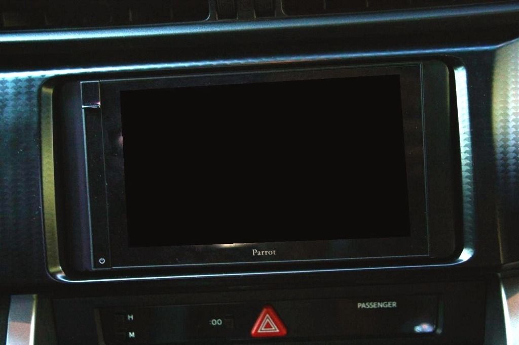

Is the radio catching on the top or bottom of the panel? I've found that you need to get the angle of the radio just right else it won't fit. No dremmeling required.

Not the best pic but this is without modifying any of the edges:

For mine bro, i dremmeled off the top and bottom lip of the head unit and used the beat sonic bracket, i had to wiggle the bezel for it to fit flush but it works

I dremeled the sides and trimmed the front of the Metra kit. They sit in frontt of the side tabs on the head unit. Trim off the the little lip on the front of the Metra pieces to make them "skinnier" (when looking at them installed). Does that make sense.
i had mine sitting in front of the side bevel of the headunit (not behind, like the picture posted a few posts above) and the dash panel was hitting the left and right sides of the metra kit. It was as if the HU with the metra kit was way too wide to fit in the space that the dash panel allows. Nearly a quarter inch it seems from looking at it.

Yup, it's too wide, the metra kit has a small protrusion on the front inner faces. I dremeled them down to flush with the rest of the piece and it fits perfectly.
