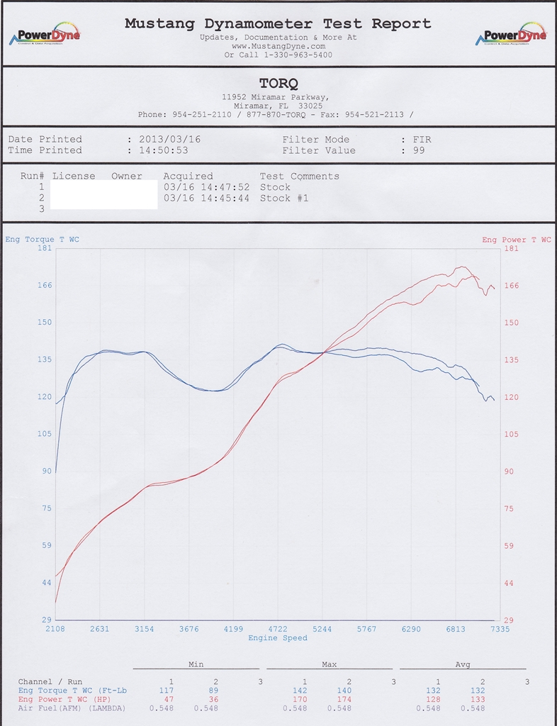

Dyno results, ONLY mod Nameless Downpipe. (Yes, I know, no baseline....)
DISCLAIMER: NO Baseline before Donwpipe mod exists.
So, I wanted to do a Dyno baseline before getting a FI kit soon. Unfortunately, I had no time to remove the Nameless Downpipe High Flow Cat and Helmholtz. 2.5", so the rest of the car is completely stock but this is with Nameless DP/OP combo.
See below.
Numbers look good considering it is a Mustang Dyno but really, there is no baseline. Max numbers were 175 WHP, 142 WTQ. IMHO I'd say the Downpipe makes anything from 5-12 WHP and 5-10 WTQ. Numbers were SAE corrected. Thoughts, opinions?
I'm really sorry for the crappy Dyno image.....

Mustang dyno should read lower than Dynojet, since you dyno more than most people's baseline with Dynojet I am thinking this mod probably gave you roughly 15-18whp. That's impressive, but I am curious how much it helps in the midrange.

I guess that to look at how the mid range is affected, a good starting point would be their original Dyno sheet. (I agree with you that the numbers look impressive, but stated in the OP 5-12 WHP gains to be ultraconservative and erring on the lower side).

Is it with the High Flow Catalytic Converter or not?

Yes, High Flow Cat and Helmholtz. 2.5" OP updated.

Very impressive figures, especially without a tune.
What a shame you can't do a baseline run then I could show MRT in Oz that exhaust mods can produce real power without a tune.
MRT
We have just about run out of brands and designs to test that will deliver real results.
So far we have seen exhaust that will generate "some" power over a stock zorst with stock ecu tune, but these gains are mainly due to removal of the two cats.

This is on stock air box? With oe filter??

Yes, everything else in the car is bone stock.
(sound generator is removed and plugged, but that does not count as a mod).

I think that's great then. +1 nameless is what i say, heck yah
I'm glad to finally see dyno results popping up

Looking at the results off the dynojet sheet... I made about the same with the motiv hfc and op. stock filter. I have a dyno sheet ill post when I get back home. After I got the tune it pulled 188hp. Oil temperatures were pretty high, considering I did a 4 hr drive to get it tuned...and I added a works drop in filter after that. I should be at about 190 now. Again ill post my dyno sheet later when I get home.
