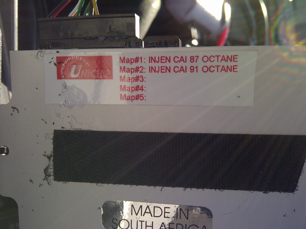

So does this mean I should run 91 until I get a cable?

I would run at least 91.
Weird though, in the Maps DB, there is no such thing as a 91 map. They are 87, 89 and 92.

I usually run 93

@ML - I wonder why Unichip marked yours as 91 Octane when you guys run 93 in NC.
I'm guessing Jack put the 92 Oct map with Timing Out, since I think that's the equivalent to 91 Octane.

I don't think he fills the orders personally though. It is a medium sized company it seems.

Sorry for the confusion... I'll look into why that label was printed "91."
Because of the differences in regional and seasonal fuel blends, we program things with a 92 octane "middle of the road" premium map in switch position 1. That map would work well with most 91-93 octane blends.
Unless otherwise requested, everything is shipped 87 Fuel Standard/Timing Standard in switch position 0 and 92 Fuel Standard/Timing Standard in switch position 1.
If anybody has any questions about that, please shoot me a pm and I'll be happy to clear things up.

The bottom of your unichip should have a sticker that says what map is loaded in 0 and 1. Otherwise, there's no other way of knowing. The software does not show what is currently installed in the unichip (which I think should be a feature in the software).
If you have the flux2, it shows you exactly what is installed. I have been working with a local tuner on e85 btw. I'll probably have a rough tune I can send to jack hopefully by the end of the month

>>If you have the flux2, it shows you exactly what is installed<<
That's not true.
The Flux2 has a programable LCD display. It by no means correlates what the display says to the tune installed.
This weekend we installed a UniChip system w/Flux2 on my buddies black BRZ. We loaded the tunes and modified the LCD display to match. Both manual operations.

Questions for Jack or anyone who has just the Unichip system (no Flux 2). The two settings are + and - and the switch is O and -. Which setting is high octane and low and how do the positions on the switch correlate with the settings? Thanks!

Position 0 on the switch (0 depressed), is the low octane map. Position 1 on the switch is the high octane.

That's correct that you do have to manually rename the map, but if you take the time to do so, it will show you which is installed.
Also, Jack does program the names of each tune in when he delivers it to you, so you can cycle through each one and know which one you are using.
