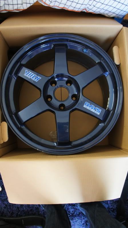

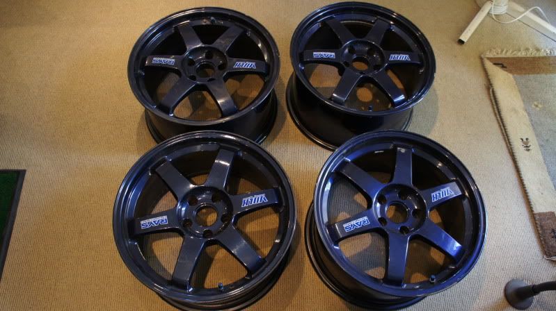

I have a question for the wheel experts, I'm looking to purchase a set of TE37 in 18x9.5, but not sure about the offset.
From the pics I see, the +45 offset seem to be more concave then +40 offsets, but from what I understand the lower the offset, the more concavity there should be. From the pic below, the +40 offset seems like it's a flat face.
18x9.5 +45 all around:
18x9.5 +40:
Can anyone explain this?

Yes, those are different types of TE37's. The Concave versions are newer, I think they are called SL's. Can anyone confirm? The bottom ones are just normal TE37's.

The 18x9.5 +40 5x100 has the same concave, Rays made that spec for Mackin Industries to sell to the US Market.

The TE37 Super Lap 18x9.5 +45 5x100 is concaved, also available in 17", its made for the BRZ/86, the regular TE37 is flat until you go 9.5 offset 28+ or 9.0 +22 but its only in 5x114.3 pcd

not necessarily. a wheel manufacturer will usually make molds for only a few faces at each diameter. then they will use those faces for a range of offsets, adjusting the backspacing to fine-tune the offset throughout the range.
basic example: 18" diameter wheel
8.5 width with a HIGH offset gets face 1 (flat)
8.5 width with a LOW offset gets face 2 (barely concave)
9.5 width with a HIGH offset gets face 2
9.5 width with a LOW offset gets face 3 (concave)
and so on...
so an 8.5 wheel with a +40 offset and an 8.5 wheel with a +45 offset would use the same face, they just mill an extra 5mm off the mounting surface to adjust between +40 and +45..
so for your situation, it is doubtful to me that volk would make a completely new face for the 5mm difference between +40 and +45 at the same width.

18x9.5 +40 TE37SL 5x100 made for BRZ / FRS will be using the 18x9.5 +22 mold which are the more concave one.
The front will be 18x8.5 +35 and the rear will be 18x9.5 +40
That's ur only option as of now. 18x8.5 +35 will be flat face.
Although they do make other offset, but only in 5x114.3
Shu5892001 / please ignore the PM i sent you.
Basically TE37SL options are
18x8.5 +33 or 18x9.5 +40
NOTE: 18x9.5 +40 will clear STI brembo caliper in the front.
