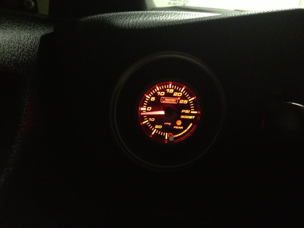

Just finished my install, took about an hour from start to finish.
