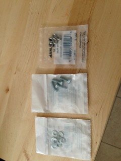

Yeah just came back from Lowe's and picked these up. M5-.80 x 16's with wave washers and hex nuts. Going to try to use these for grounding of both the high and low. They're 8mm hex not 10mm. Hopefully they'll work just as well. Forgoing the Hella-provided relay too for my install. Name:  ImageUploadedByTapatalk1361642960.185459.jpg

Sorry for the confusion. 10mm refers to the size of the head, thus the wrench or socket used to remove this bolt would be a 10mm wrench. In reality it would be a m6x1.0mm bolt. m6 meaning metric 6mm. 1.0mm would be the thread pitch. in this case length is not specified.

I ended up drilling two holes in the bumper to get my two grounds since my rings weren't the correct size. I always seem to have difficulty finding rings to tap into existing stock bolts even when I was more active doing car stereo stuff.
