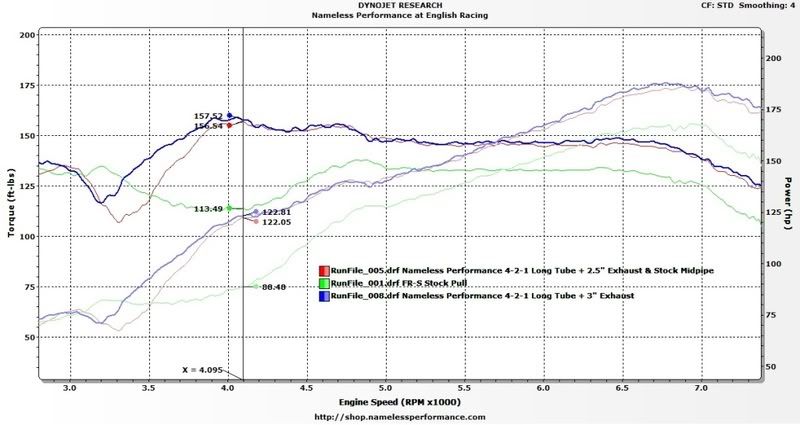

Here's another graph to show vs. stock. We're losing power somewhere here, but I'll tell you this much: I've driven both. Like I stole the car. And they are both f-all fast compared to even our other header setup w/ the full exhaust.
We will keep playing with various items on this and see what we can shake out. I'm curious if the stock midpipe is impacting any of this and we just have to figure out what to test next. Bottom line - this header is wicked.

I was thinking that 2.1" midpipe is choking the system but I could be completely wrong. Was the 3" system tested with the stock midpipe as well? Just throwing out ideas. I'm baffled the dip returned.
Dyno Graph:
I can't wait to go drive it again. If you want to check the car out, it'll be at Cascade Cars & Coffee Portland with it tomorrow AM.
Jason
Do you have this graph with AFRs?
Is there a corresponding slight richening in the 'regression' area?
Because titanium.
If that were the case wouldn't it show up top rather than in the middle? Other than the great gains just about everywhere, there is some weird stuff going on in the dip area.
