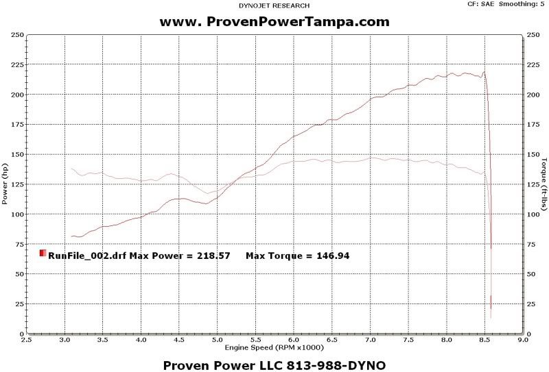

This k20 i/h/e/kpro powerband would be awesome in our car:
No, no it wouldn't.
Here's an overlay of the K20 with I/RH/E/Kpro and my FA20 with I/E/ECUTek.
The K20 would just make our cars feel much slower on the low end. It only begins making more power at 6900 RPM. So I mean, if you want to stay above 6900 RPM, sure you'll be faster, but for the 95% of driving done below... not a chance. haha
Also, I'm pretty sure a full race header and tune on the FA20 would lift that falling torque quite a bit higher up in the rev range.
