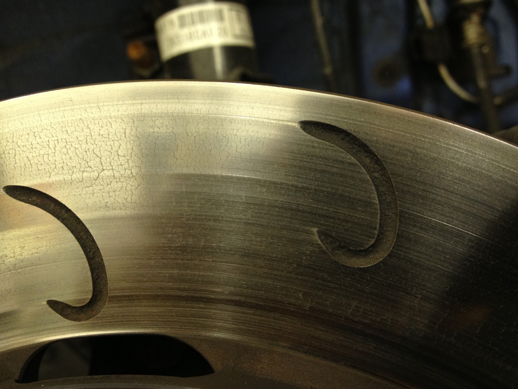

I'll try to make the time to take pictures of the pads that are off the car currently (2 sets) to show how even the wear is. No crazy tapering like on my s2k... :jealous:
And the responses are coming quickly! Yes, I'm referring to radial grooves on the rotor
BTW I finally took a pic to show what I think @Hanakuso was talking about when he mentioned grooving from the J-Hooks:
Obviously nothing to worry about, but I figured I'd see if this is what he meant.
