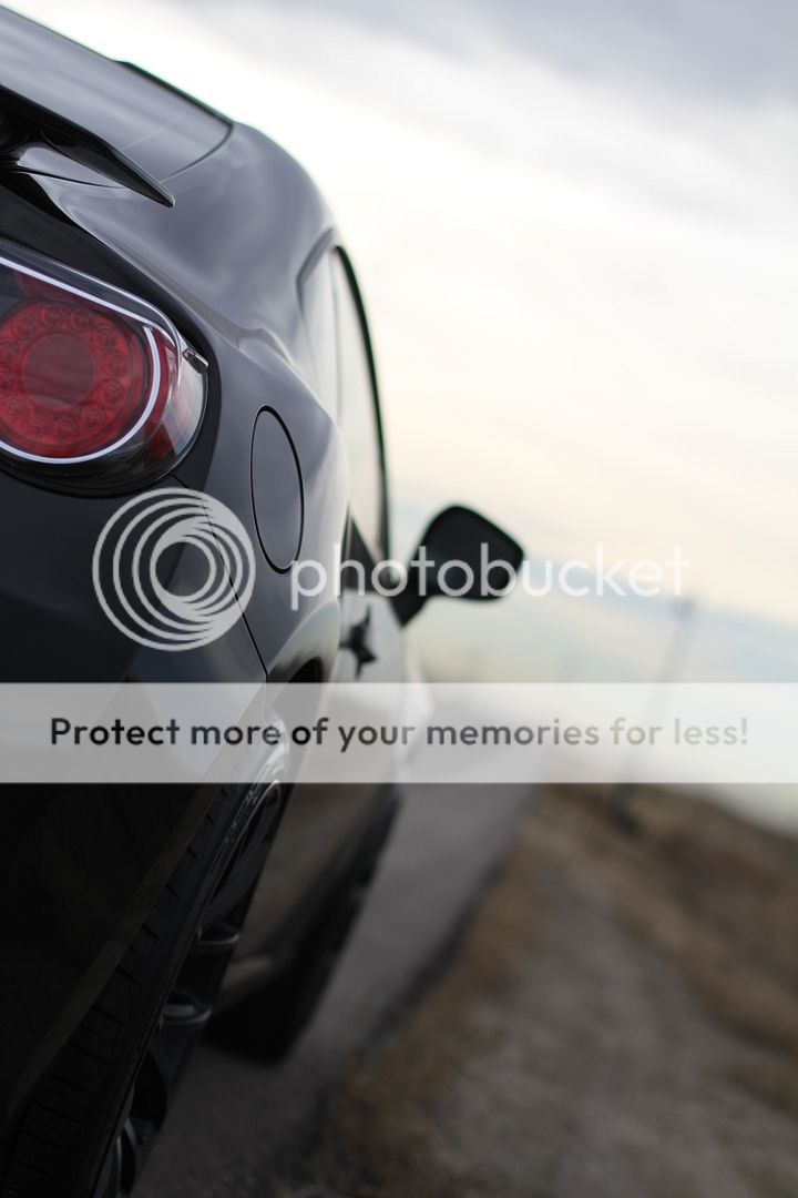

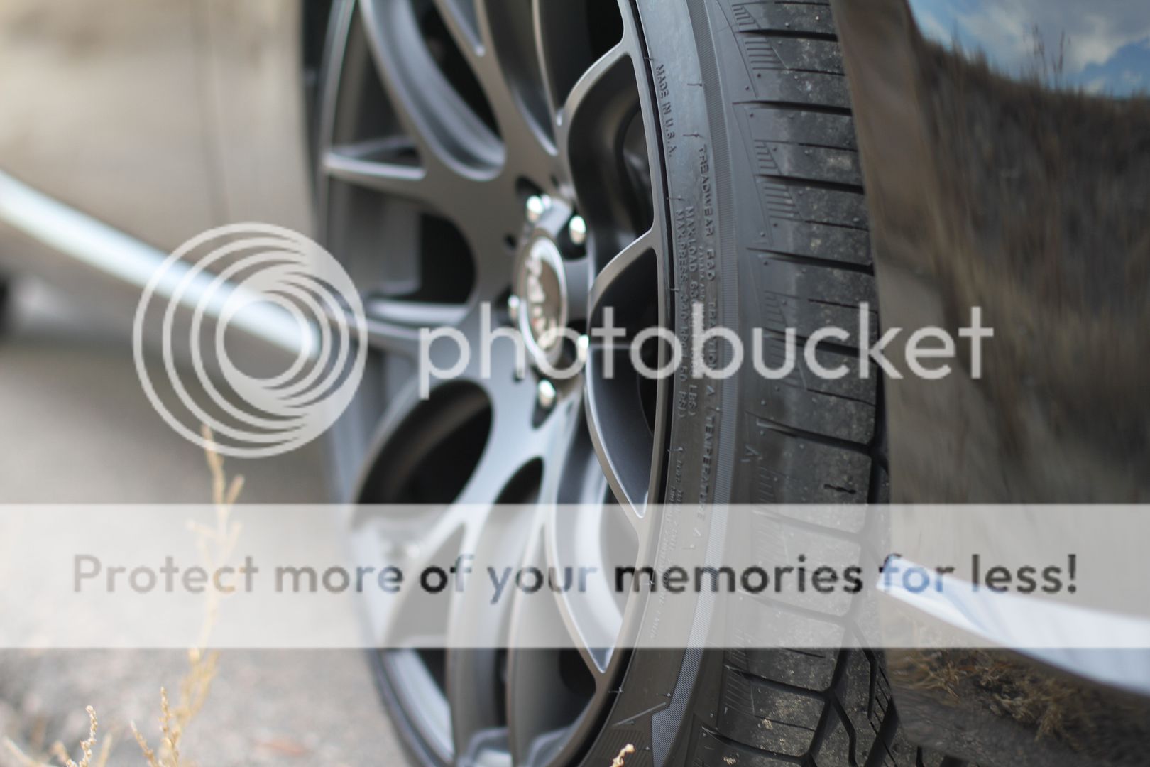

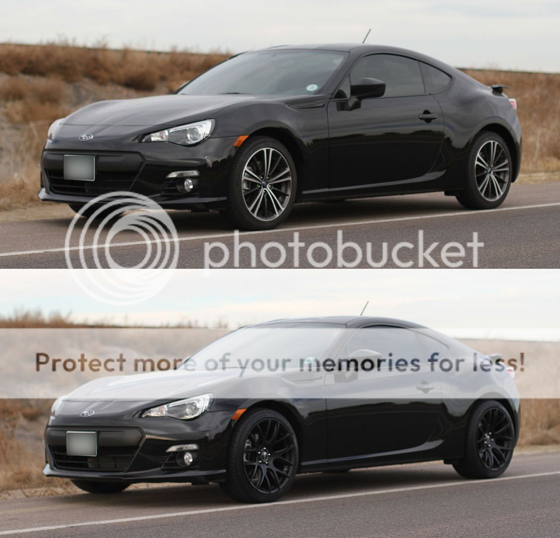

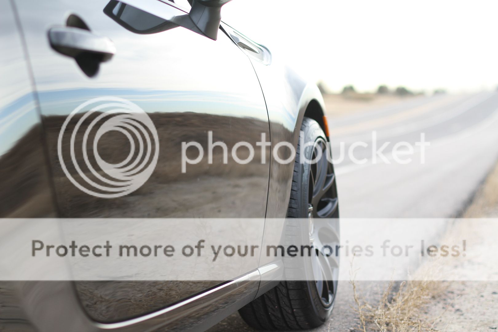

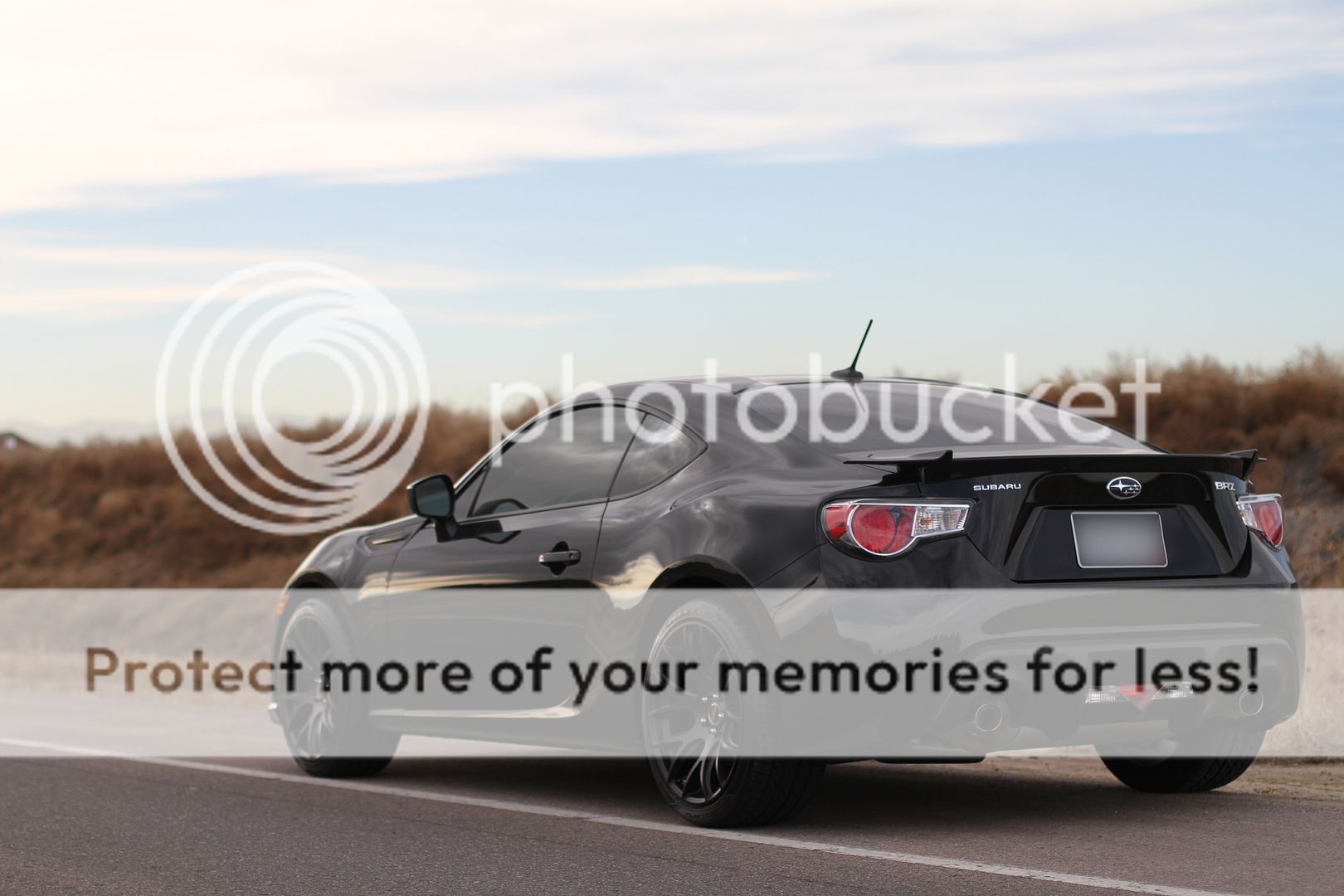

New wheels and tires with Eibach Sportlines, Miro 111
Just got my new wheels and tires. Like the look a lot, but still too much gap. Ordered some eibach sportlines and plan to put on this weekend. Sure hope they fit with these wheels and tires....Any thoughts? Also need to order some black lug nuts.
Miro 111
Front: 18x8.5 35 225/40/18
Rear: 18x9.5 40 255/35/18

I like the wheels, but the tires just seem to wide imo. Maybe if it was a little lower. I'm curious, but, why the thinner sidewall tires on the rear?

I'm the opposite of jayde... I think the tires should be wider then the rims.. I like the fact you didn't stretch yours.. Good job

Both tires sidewalls are the same height. Staggered tires usually drop 1 aspect ratio for the rear tires. 35 from 40. The number is a % of the section width. So 35% of 255 = 40% of 225. The math is not exactly perfect, but close enough for how tires work.
http://www.discounttire.com/dtcs/infoTireMath.dos Here is a tire calculator that will help anyone understand tire sizes better...
I love the wheels and tire sizes! Great job! Can't wait to see it when its lowered.

Looks good, i would go ahead and order some OEM camber bolts for the front and be prepared to get something for the rear too if you need camber adjustment. I wouldn't get black lugnuts you need some contrast there i don't think it will look good completely blacked out. Maybe get some red ones or like a gunmetal color if you don't like the chrome.
