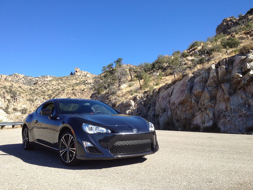

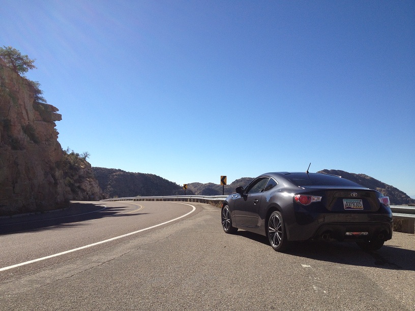

I went to Mt Lemmon this morning before coming back to Phx. I spotted a Raven FRS on the I10 and waved, not sure if he's on here though...

Its such a nice drive up there.
