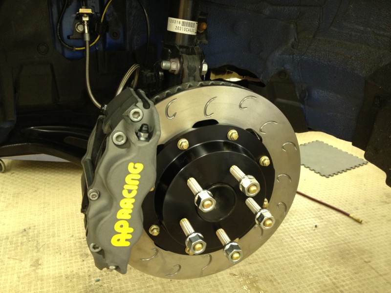

Finally had a couple of hours to spend on the BRZ yesterday. My rears still look good, plenty of rear pad left
So for the front, I installed the Essex Spring kit, also removed the hubs and swapped lugstuds to ARP extended studs. Will post pics of the old front components in a few days, rotors weren't bad minus the delamination, pads were probably at 30% left but didn't look too bad, calipers weren't leaking, dust boots turn to dust if you touch them of course.
For all those 5x114.3 people I wonder if an STI hub has the same bolt pattern? If so it might swap over although usually bearings/hubs designed for a driveshaft don't last long without them...
Pic of the front driver side:

dave what were your driving and bias/trail braking impressions under HARD/HOT cornering? I'm talking error correction near apex, does the tail fly out?

The car doesn't trail brake for shit, the stupid slip light just flashes instead and EBD tries it's best to prevent effective trail braking. Maybe running a more agressive rear pad will help, I'm only running Carbotech XP8s in the back right now. Someone else (matt? or pcasso? or CSG?) got the car to behave better for trail braking by running narrower rear tires, we do that to get rotation in the FWD race car too.
I've never had the tail fly out on this car (on the track anyways). I need to play with alignment eventually but I'll do that when I need to fine tune it.. right now it's pretty balanced and doesn't understeer or oversteer.

How did you replace wheel studs? Did you press them out or hammer them out?
