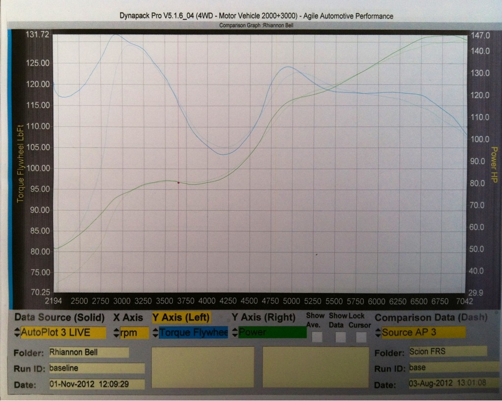

#81 Baseline dyno of stock BRZ after hard parts replace & ecu flash
Dyno done this am, thanks to all that contributed. I am happy to announce full faith restored in my car.

end result, no hp/tq loss where it counts. It dips a tad lower than stock frs but is over a tad in places that matter. (minute differences)
Over all I am happy to see the car performs where it should and am excited to get the ball rolling on upgrades in due time.
Attachment 19467
Attachment 19468
Attachment 19469
I am always glad to contribute to the useful information we can provide to better inform or 86ers community.
Looks well within run-to-run variances.
