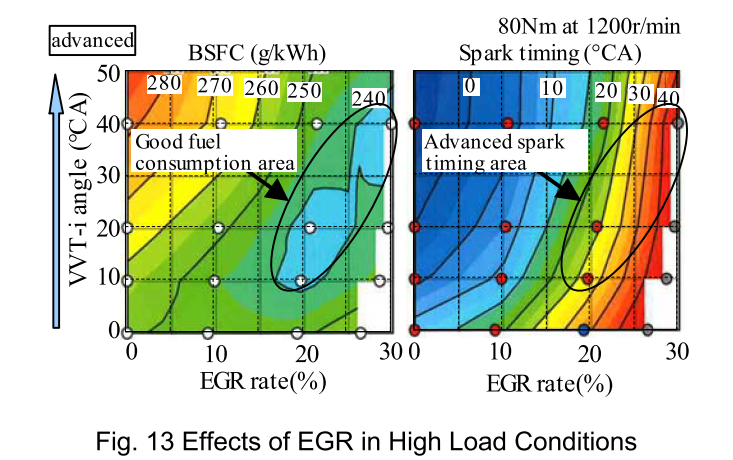

They control knock with cooled EGR:
higher cooled EGR flow rates allow more advanced spark timing.
