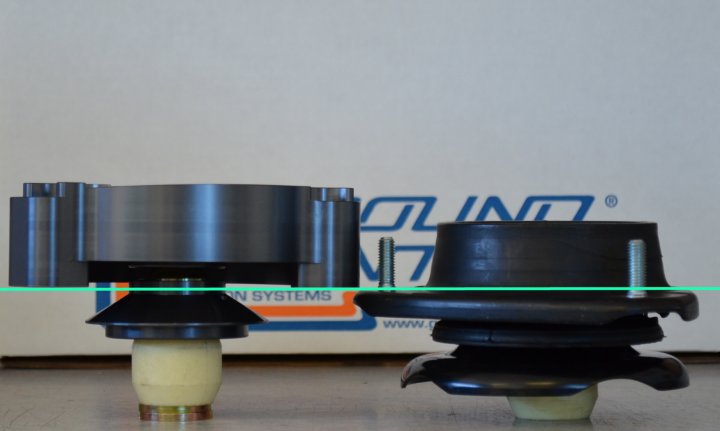

Originally Posted by Phaedrus29 View Post
I am realizing now that some of these plates will increase ride height in front if used with the stock struts. Are there any out there that won't?
The Ground Control camber/caster plates do not take away suspension travel.
By mounting above the sheetmetal, we are able to let the strut shaft come up through the inner fender, instead of stopping short.
In fact, in this picture we had to use a spacer to move the GC camber/caster plate upward, simulating the extra suspension travel, to illustrate the relationship.

So do these plates actually lower ride height? If so, by how much? Link to more pics/info/price please.
I can't really tell from the pic, but how can these work with the stock struts...where's the top spring perch?
I don't know the exact amount, but you can see the difference between the ride height at where the upper spring seats are located in comparison to the green line which is representing the body.
Our plates will work with OE struts, but not OE springs. However we are exploring oe spring mounting options.
