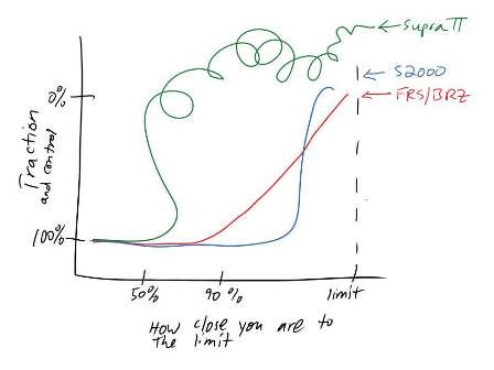

True. However, I do believe that the stock S2000 is a bit tricky to drive at the limits, the AP1 being more twitchy. While I don't fully understand the physics behind the suspension and chassis that contribute to this characteristic, the short wheelbase probably plays a role.
Notice the small window for the S2000 to transition from complete grip and control to going out-of-control, whereas the FRS/BRZ has a more linear and wider transition window. Note: plot is not based on scientific research.

I printed this for my Garage...That shit is Hilarious!!
