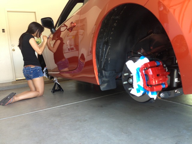

Size:  66.4 KBDid my calipers and emblems today

1. How many coats of base and clear did you use. What temp and how long did you bake them?
2. Can anyone point me in the direction of drilled and slotted rotors for the FRS. I would like to buy them when I have the calipers off and are painting them.
I searched the web but couldnt find any but I have seen pics on the forum with members who have them on there cars. Also do they make caliper covers yet. I know they make them for my mustang I was hoping or thinking of buying them if the fitment is correct and repainting them as it looks like its a big break kit?

G2 caliper paint was used. It was brush on so the calipers just stay in place on the car. No baking or clear coat needed. Cost about 38 bucks for enough for all 4. 5 out of 5 rating on amazon for the stuff. They look great.

The caliper paint is VHT 2 cans red / one clear . Baked @ 200 for 1 hour. The calipers were totaly removed and disassembled , painted , then re-assembled , system bleed.
