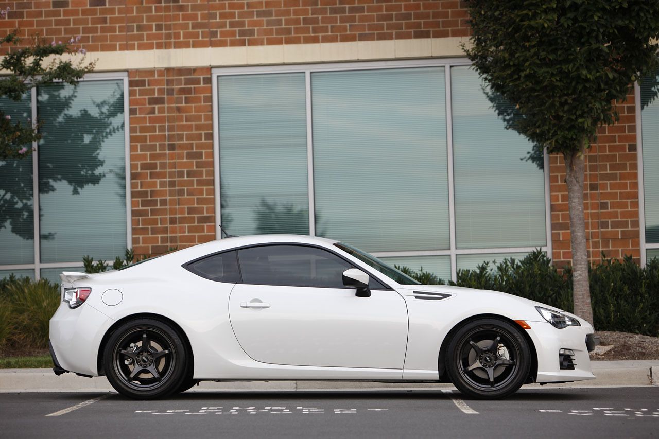

Tein s-tech 1.5 drop
This is as close as your going to get to coilovers. Any lower and your in big long term trouble.

Originally Posted by Mach V Dan View Post
I'm partial to our springs.
--Dan
Mach V
Mach V lowering springs for Subaru BRZ and Scion FR-S lower your car approximately 0.75" in the front and 1.0" in the rear. They're 28% stiffer than stock in the front, and 30% stiffer than stock in the rear.

Originally Posted by wparsons View Post
Which stock springs are those being compared to? I would assume BRZ since that's what is shown in the pictures?
Yes. FR-S springs are the same as BRZ springs in front, but slightly firmer in the back.
