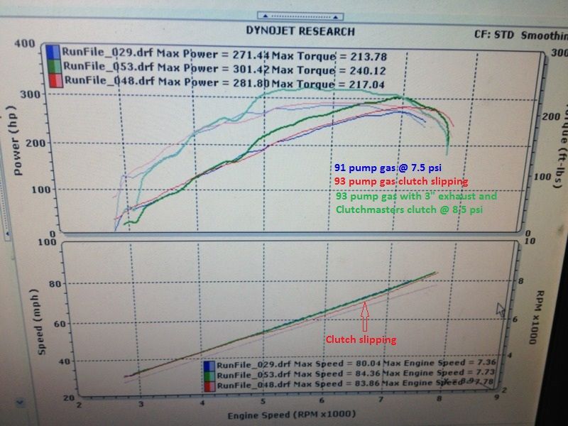

Nice work guys! 300whp is respectible for this ligthweight I think. This thing is going to be fun on the streets. Are all cats removed at this point?

Yes sir, they are all gone now.

301whp, that'll be 293whp SAE corrected that's more than enough for me for street driving with the mods listed above!!

Agreed. I don't see any issues daily driving this thing long term with this setup at this power level and clutch upgrade.

Wow just goes to show how much this car loves a nice free flowing exhaust.

Thanks guys, E85 numbers coming soon
