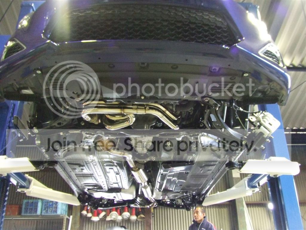

Trust/GReddy in Japan is working on a header with O2 sensor bung and apparently stock heat shield bolt-on-ability. Targeted completion in October. Here are a few prototypes...
