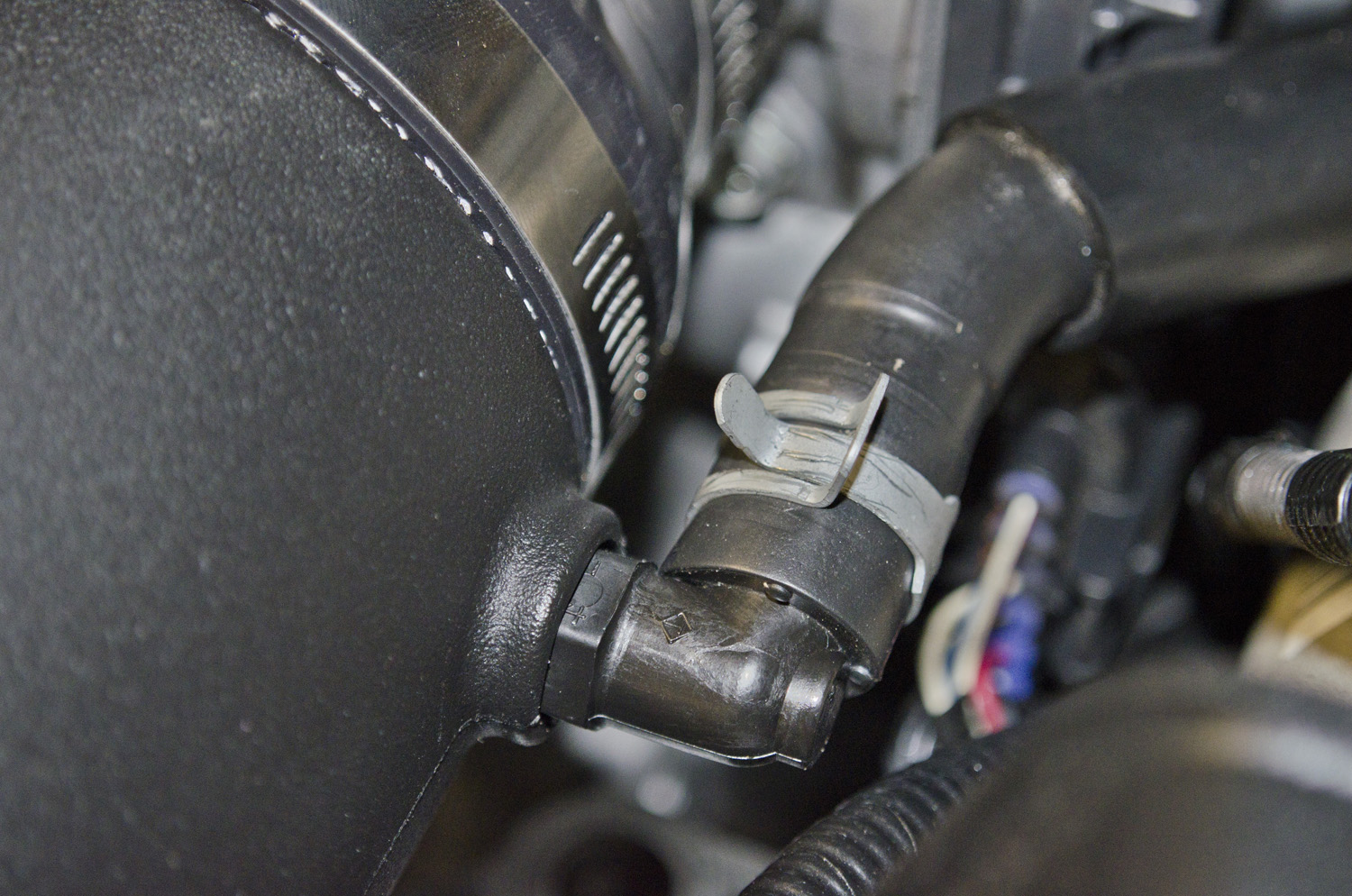

For all the doubters out there, I have finally been able to catch the bogging on video.
1st gear take off, violent bog, 60-75% throttle:
[ame="http://www.youtube.com/watch?v=tH8QIea5h_Y"]2012 09 02 11 25 36 - YouTube[/ame]
Fresh shift bog, WOT, no power:
[ame="http://www.youtube.com/watch?v=Uzi6OafbICw"]2012 09 02 11 26 36 - YouTube[/ame]
Shift to 2nd bog, WOT, jerking:
[ame="http://www.youtube.com/watch?v=214gWCgfqhQ"]2012 09 02 11 27 51 - YouTube[/ame]
I understand @David@Airaid.com offered to let me ship my intake to them to let them test it, but unfortunately, that will put me beyond the return period that @AJUSA.com offers. I don't want to run the risk of losing 250$ on the chance that the 2nd intake causes the same issues.
I'm now going to send John some more comparison logs between this intake and stock.
Also, attached are pics of the install. Please let me know if I've missed anything....
