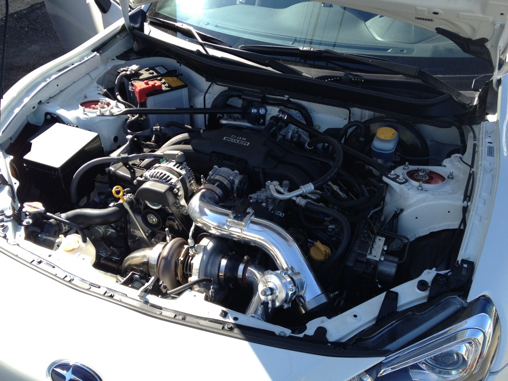

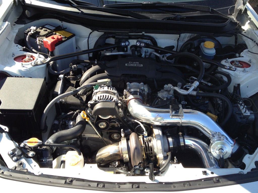

regardless I don't think that angled turbo looks good, the angle is just enough to look like a
manufacturing mistake and I don't think it would be that hard to make it parallel to the ground.
I'd prefer it at that angle, as it would make the build cost cheaper, and make the system more efficient.

thats what i thought as well but right underneath the throttle body there is a water line, right where that turbo line is going
hmm you may be right, but I can't tell 100%. If that is a water hose, it doesn't look to be insulated in any way, which would mean it'll be prone to early failure in the future from the heat from some of hte other parts around it, such as the exhaust and turbo.

I think I'm more a fan of the low-mounted turbo setups for heat, plumbing, and weight distribution reasons. I'm not planning on turbo'ing anyway, but that's my useless $.02 internet cents.
That's a braided teflon oil feed hose, it wont have any issues with heat.

wouldnt the turbo being there heat up the engine like crazy? i seen turbos get RED from the heat they produce..wouldnt it cause heat soak?
It will raise the engine bay temperature, there are ways to consolidate and control the temperature. Turbo blankets, ceramic coatings, and heat shields or wraps. It's difficult to tell from the pictures but it may also be in an area that gets a decent amount of airflow.
