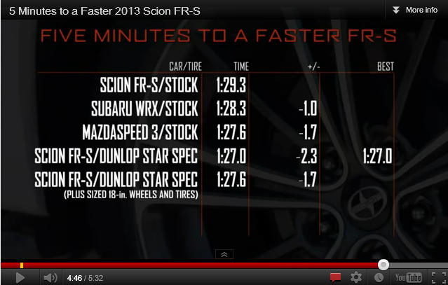

Originally Posted by Want.FR-S View Post
The key message of this video: no need to swap wider gripper tire. Just stay at the stock size.
Attachment 9467
That is entirely untrue and completely misses the difference between a 215/17 and a 235/18.
See below.
Originally Posted by Jdogg180 View Post
The larger diameter 18" rim will have it's weight farther from the hub that the same weight 17" rim so it's very likely the straight line performance was reduced as well as braking. It would be a very small amount but the margin as pretty small. So lighter wider 17's would give you more grip and if you can stay under or very close to the weight of the stock wheel tire combo you will see that wider is in fact better.
