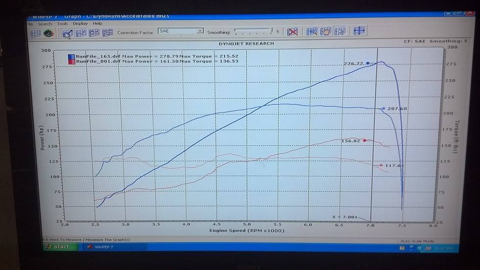

Originally Posted by Don@Accelerated View Post
Final Numbers to which we are going to test the car at. Not the highest hp and tq figures we have done, but we feel this is a nice spot to stop to test. I feel this is a good area for pumpgas users.
Don
Great work! Now this is what I envisioned from your kit from the begining. A very repectable number.

It's just crazy how smooth that dyno graph is. Looks like someone dropped a V6 from a 370Z in this thing. There is no surge of boost onset. This progressive output should do wonders on the track.

You guys running into knock issues @ 10psi? Or is the lack of injector cc the reason you're backing off a bit. I know its a fresh motor and you don't wanna blow it up.

Considering how this is for the simple turbo setup do you expect to see a big shift in gas mileage?

A good clue would be how much boost there is at highway cruising engine speeds. Now since their dyno run starts at ~2500rpm it's a little hard to tell, since the transient response of the turbo is an issue, but it looks like the turbo doesn't really "spool up" until you hit well over 3500rpm.
Any fuel economy loss at steady low load cruising conditions will be due to the turbine adding restriction to the exhaust, which doesn't seem like it's going to be a big deal. Most turbo engines "spool" well before this one does.
Under normal acceleration, engine efficiency will drop a little bit when you use boost, but again it appears there is very little boost below 3000rpm so probably not going to impact fuel economy much.
Best if they can tell you how much boost it builds in the lower engine speed ranges, and if they have any exhaust pressure readings (probably not going to be a significant increase).

god I LOVE that power and torque curve. looks amazing for the kind of car this is!
