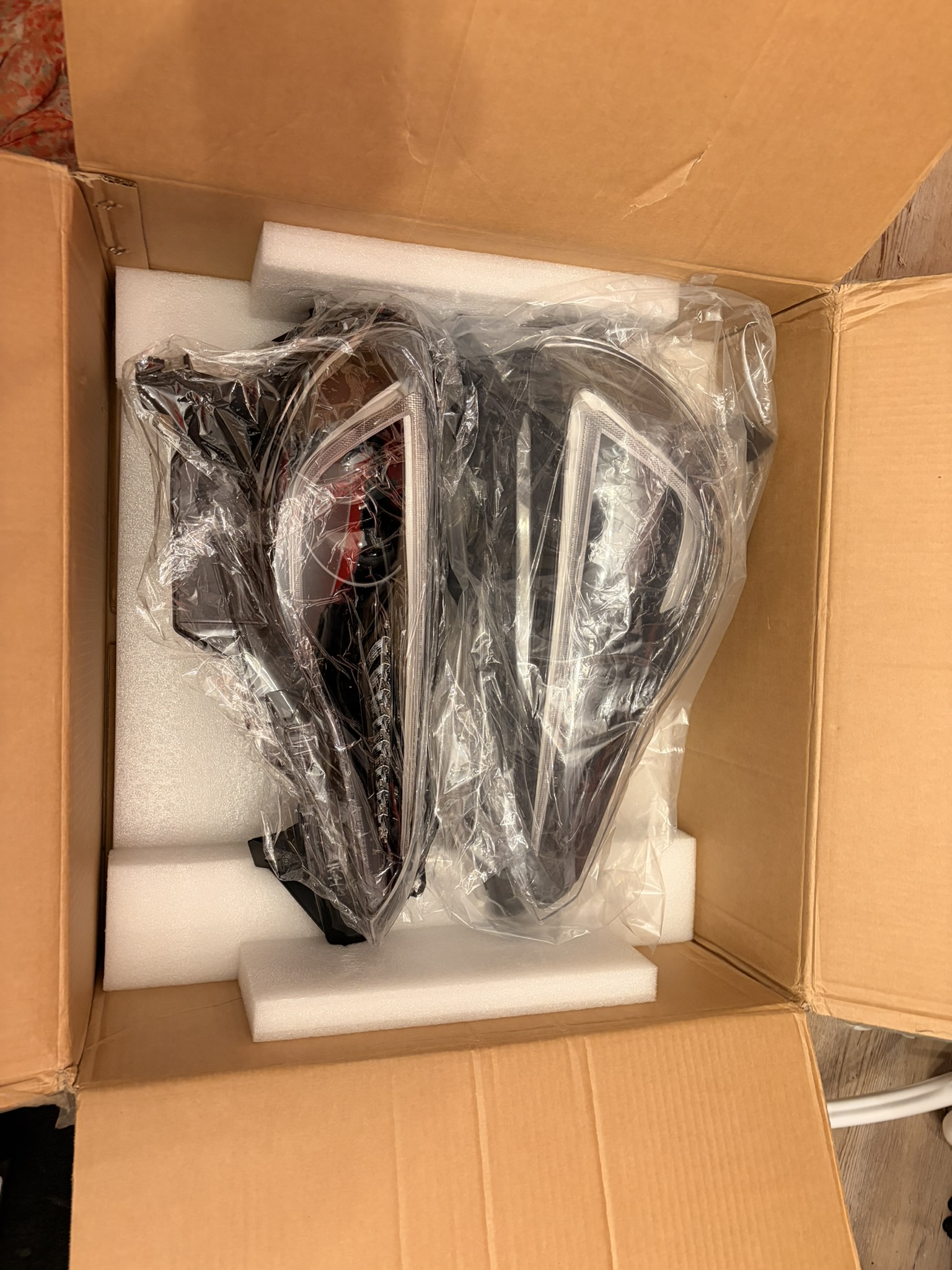

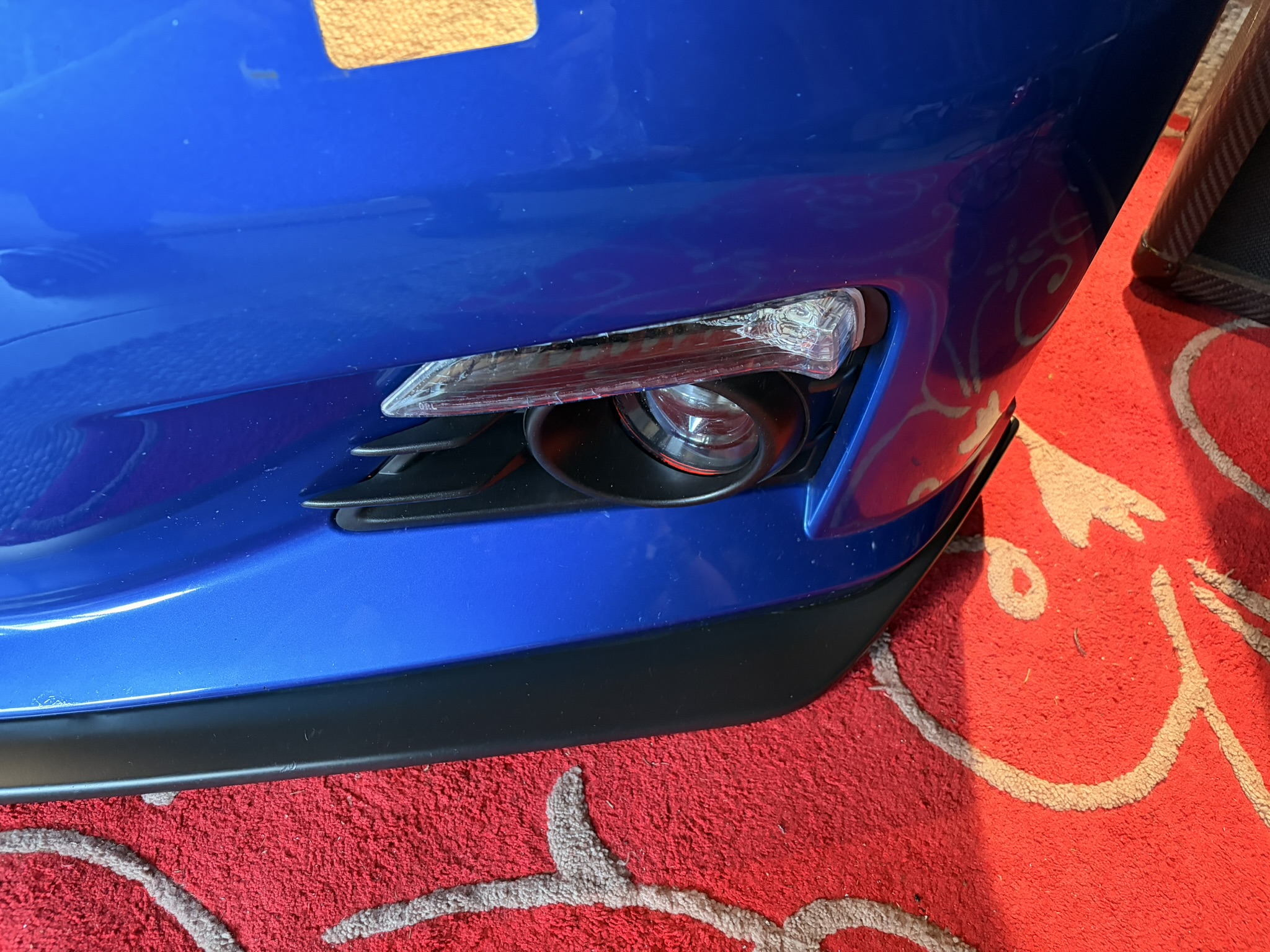

Next up, the factory tail lights had to go, and were replaced with some Valentis (as everyone seems to do).

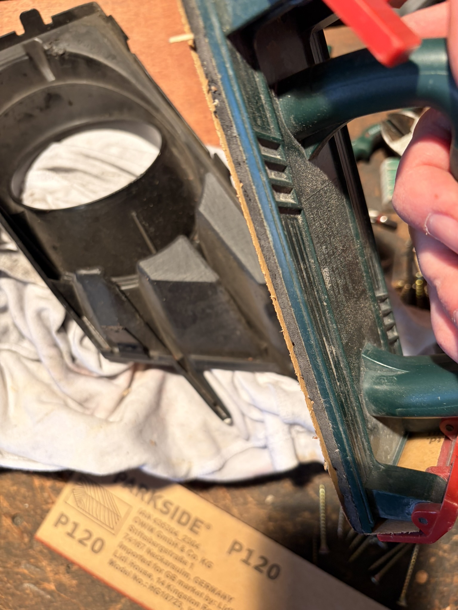

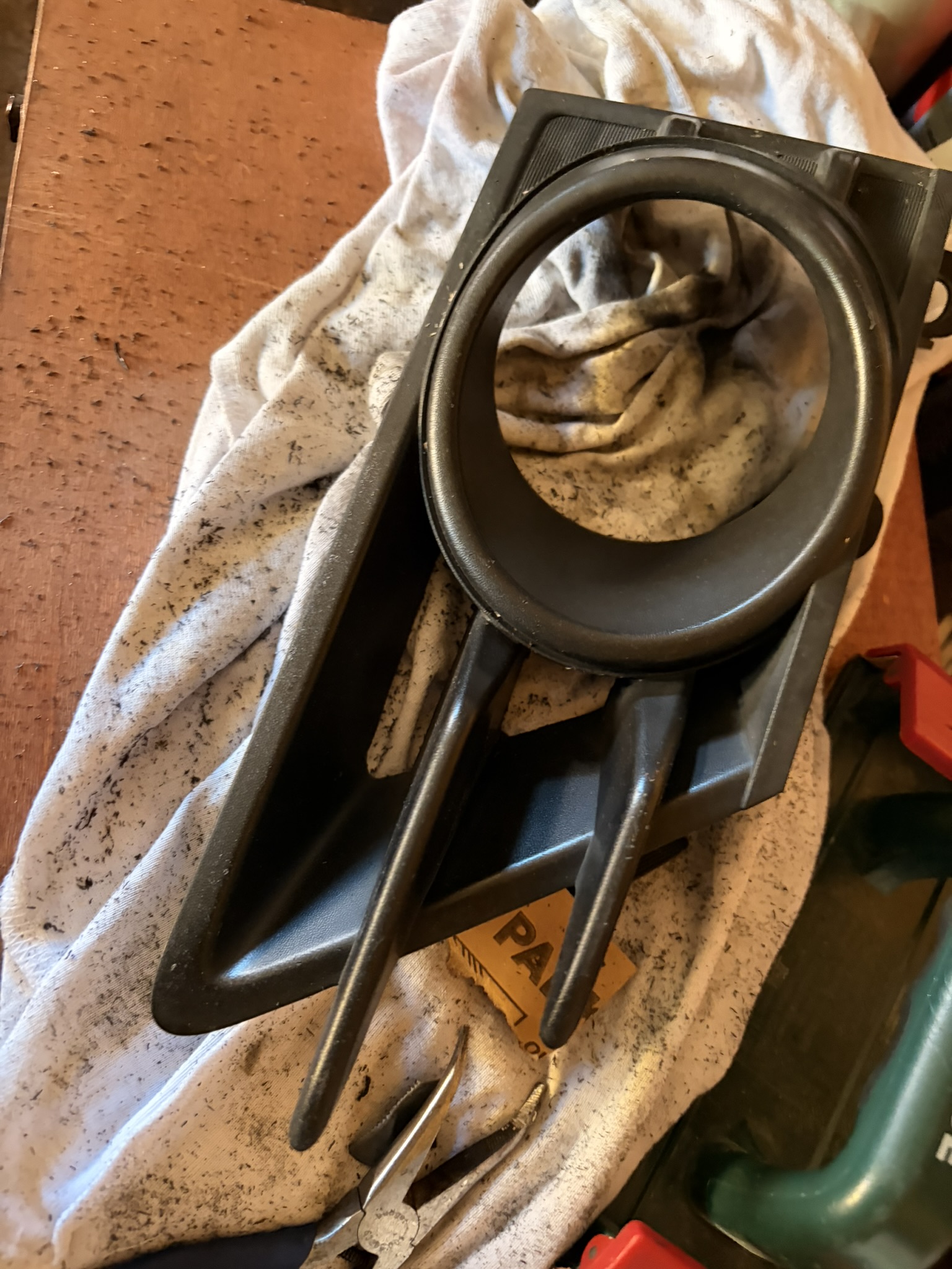

I used this opportunity to replace the Fog lights with units from a Subaru Forester, which is an upgrade to 2*55W, and also replace the license plate lights to LED units.
Left is the original Fog Light, and on right the replacement unit.
As my OCD kicked in, I also replaced the rear fog light unit with the Valenti one:

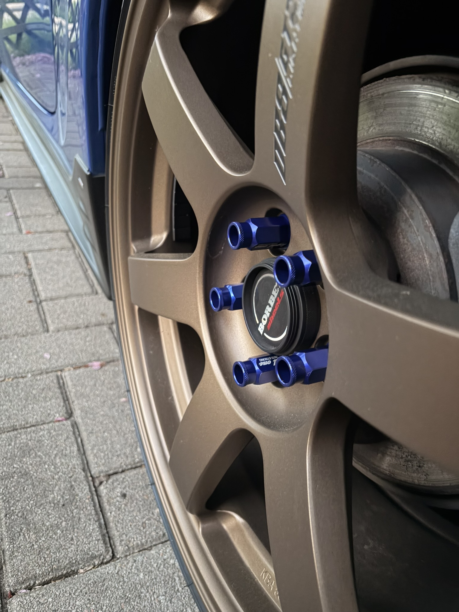

I got some custom made lug nuts from the Honda NSX forum (ball seat is otherwise impossible to find for our thread size), as well as a trunk tow strap.

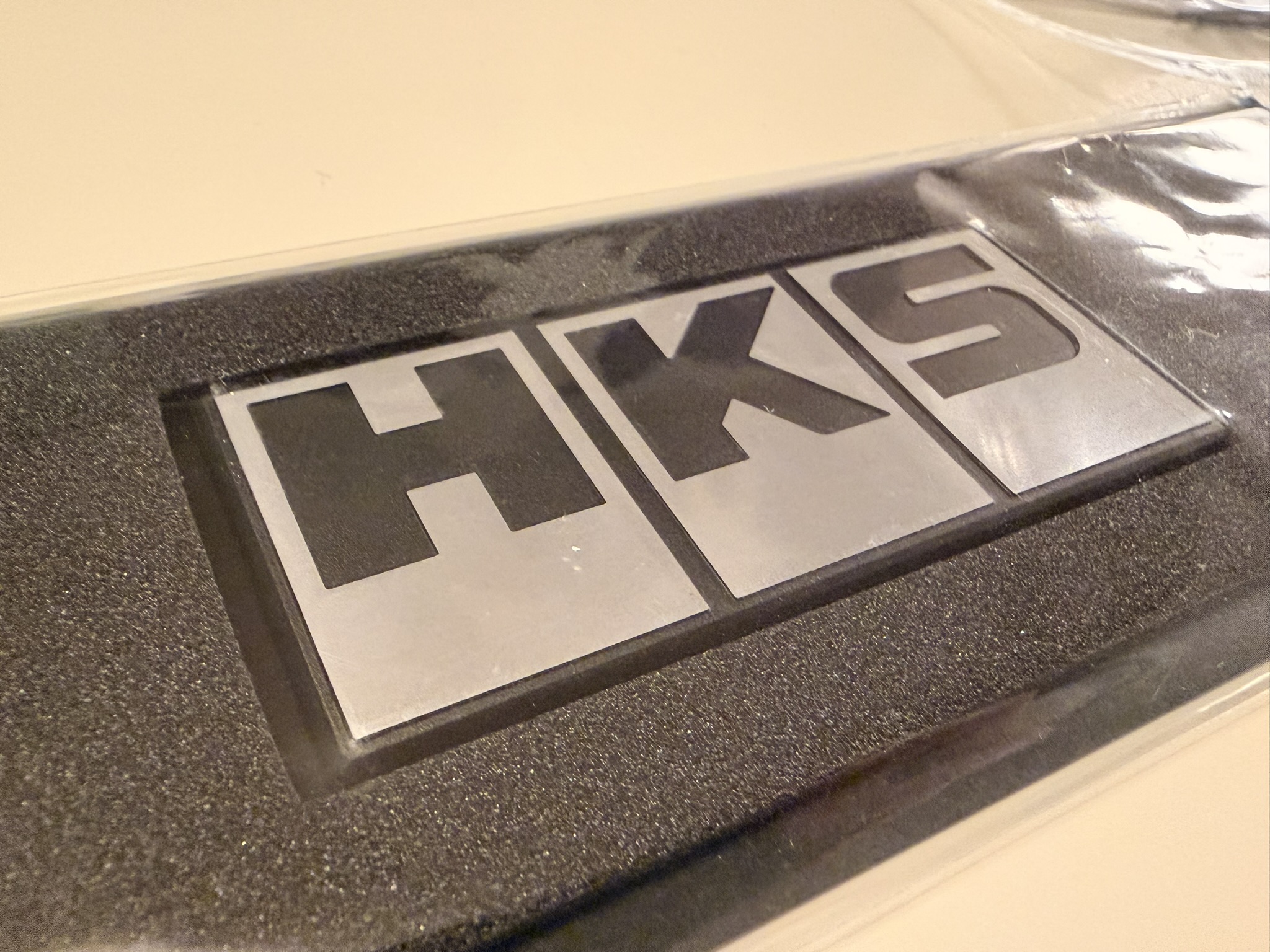

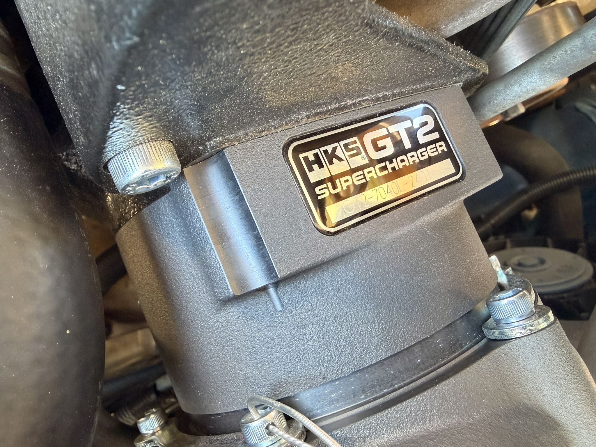

First, during winter, I bought a little HKS swag like the fanboy I am, to fully committ myself to the projects that I was planning.

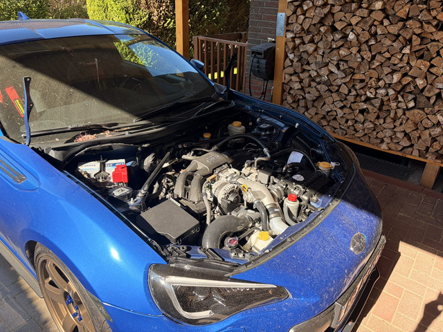

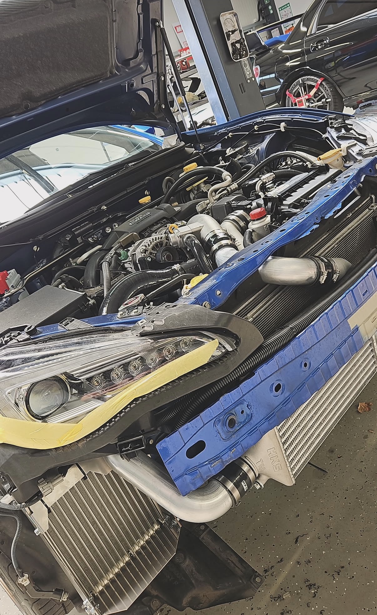

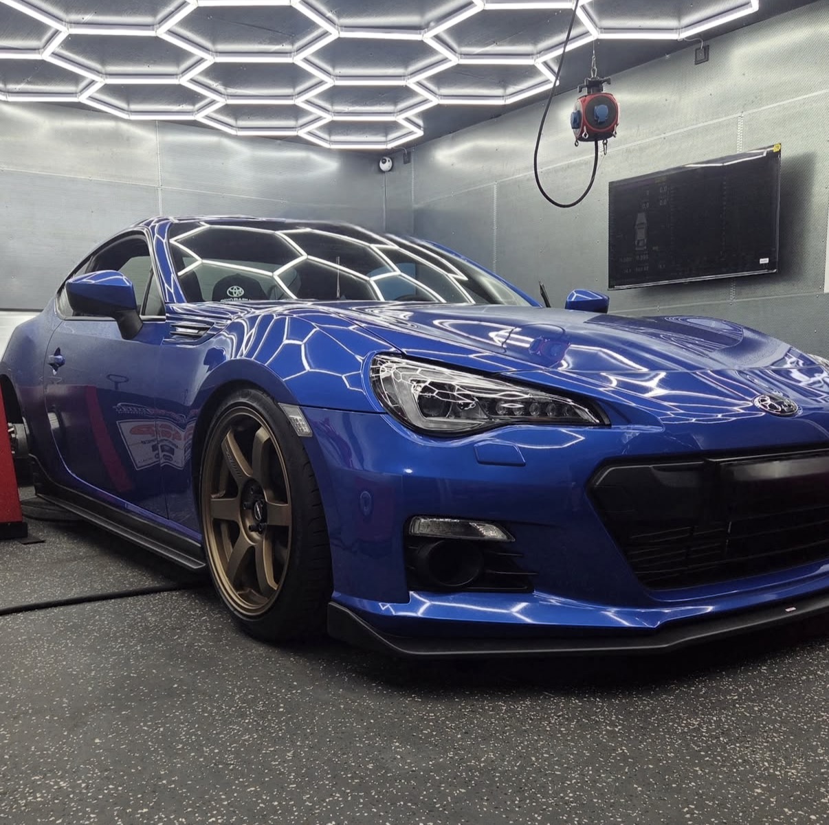

After pulling the car out of storage in mir April, I visited the "local" experts (6 hours drive), to have them finally boost my BRZ with the HKS GP2 supercharger, and throw in some more goodies while he was at it (HKS Oil Cooler, plus an Oil pressure sensor with some safety features, implemented via the OEM ECU).
I am also an Instagram Ad now.
During the conversion, my LED fog lights were removed to ensure proper air flow to the oil cooler.
Since I like my fog lights, and I hate it if there are buttons in the car which do nothing (like, for example, a button for non-existent fog lights), I consulted the HKS manual and found that for the OG BRZ, HKS states that the fog lights can remain in place as long as the bezel is cut open.
I had a few other items on my "To Do" list, so I removed the bumper alltogether:
I started by sanding the back of the bezels by hand, since my belt sander did not feel like cooperating:

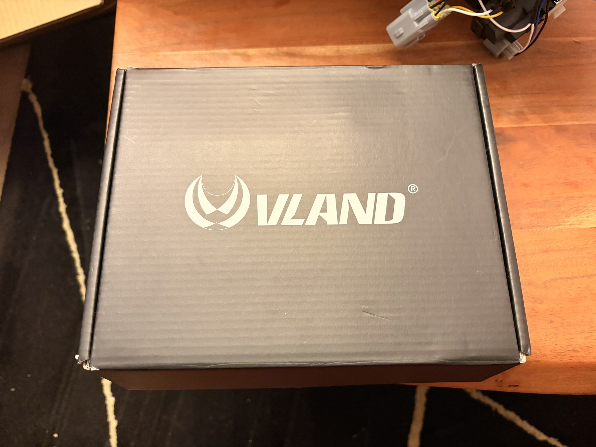

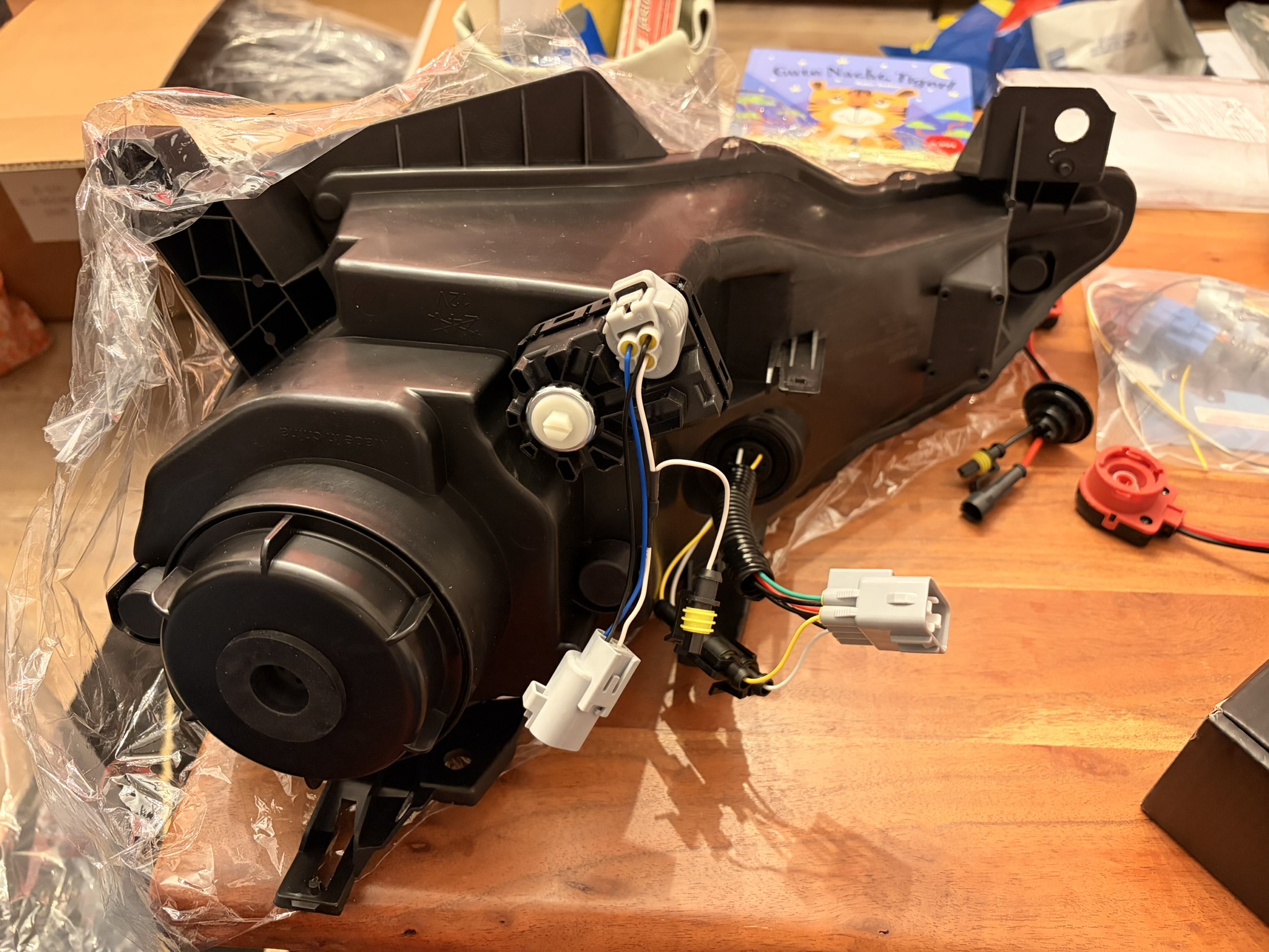

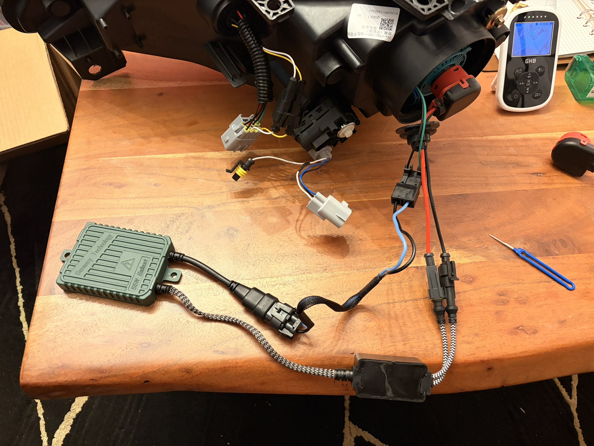

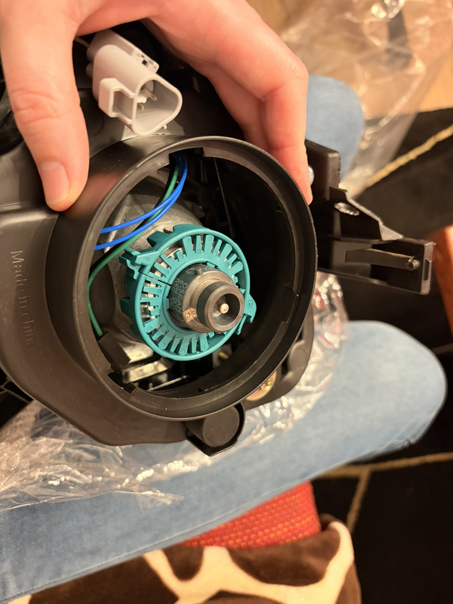

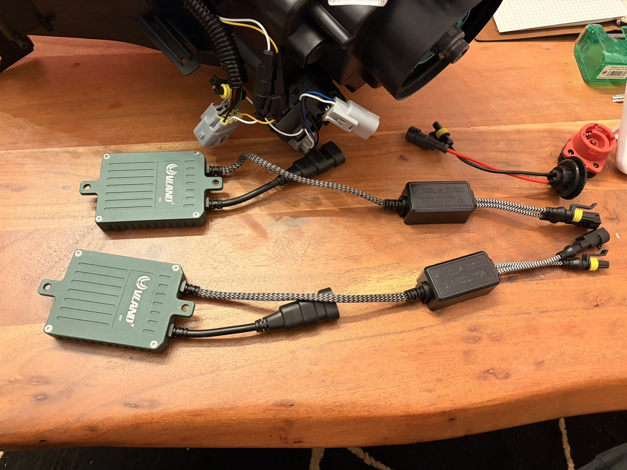

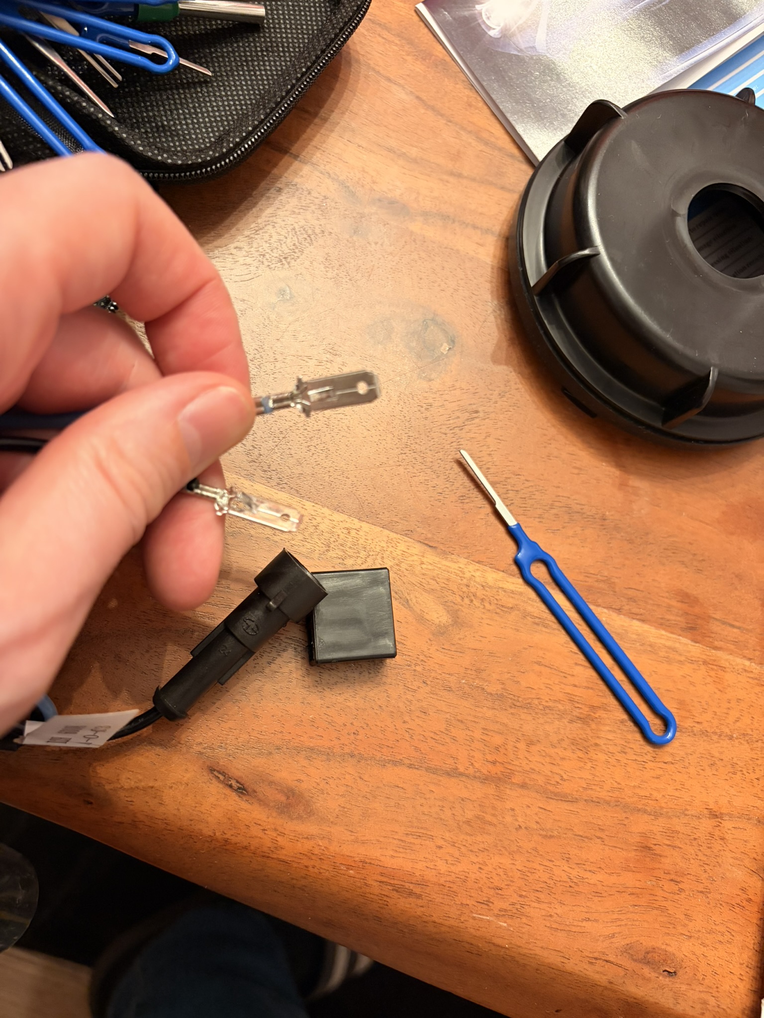

Additionally, I had ordered one of the first sets of VLand headlights with an E-mark, making them legal(ish) in my country:

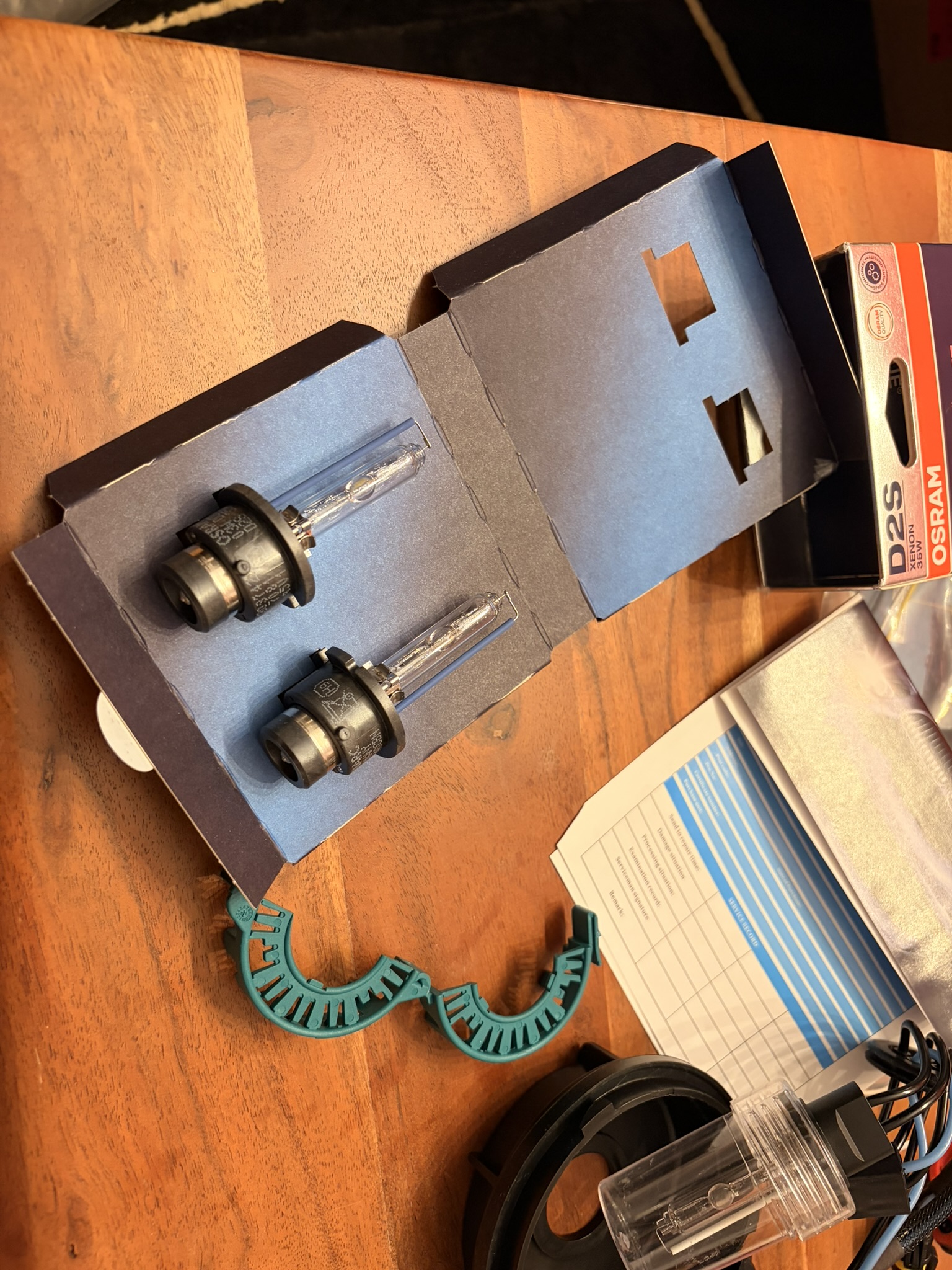

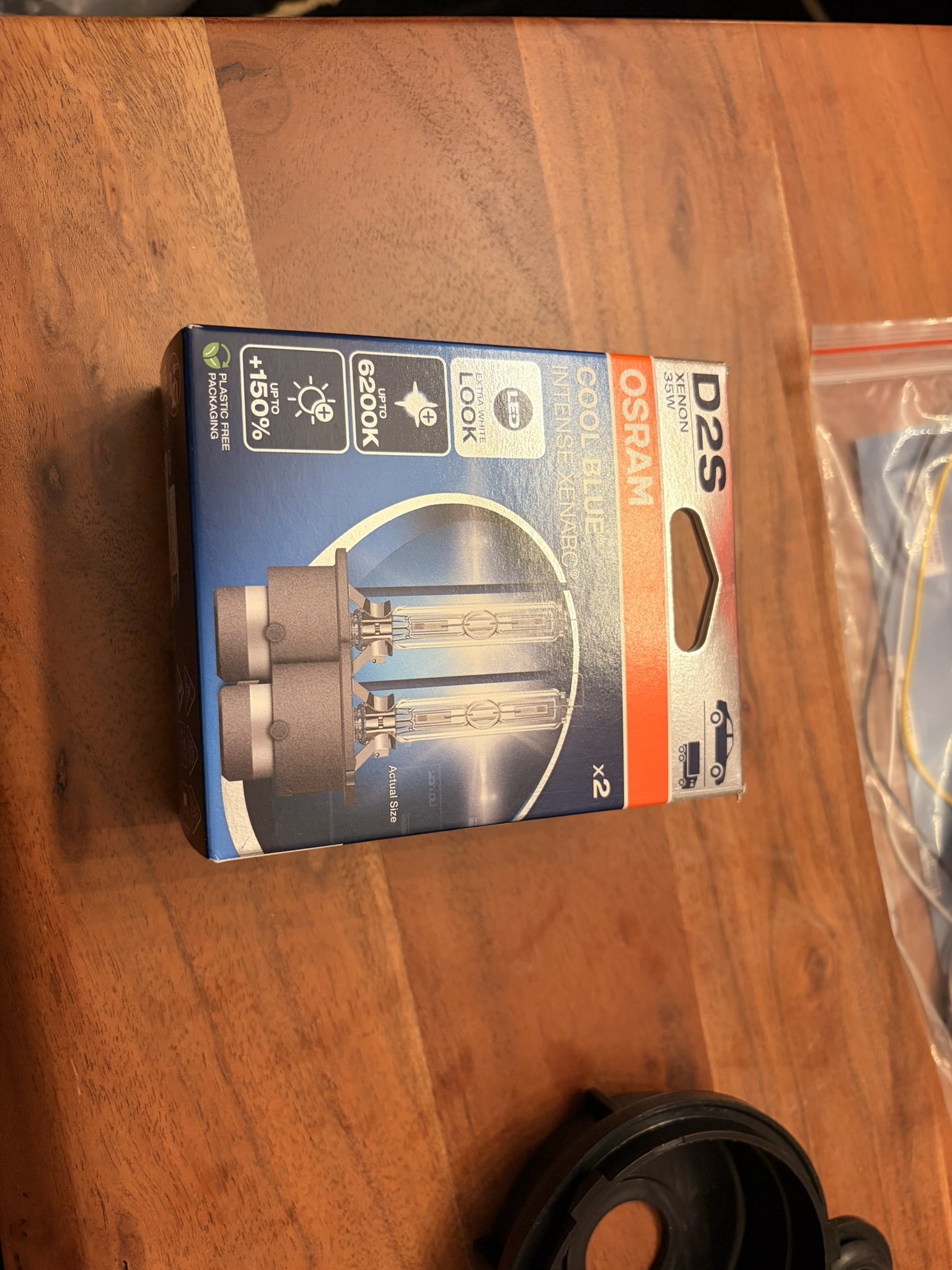

According to Vland, they can be run with D2H or D2S HID bulbs.

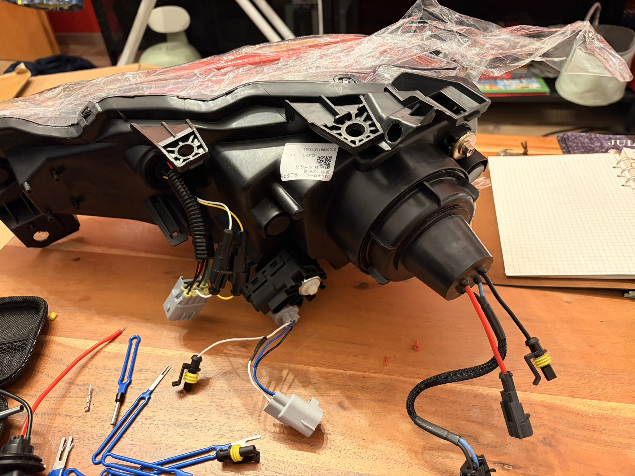

Since D2H is basically not available here, I opted for D2S Osram units and the respective Vland ballasts.

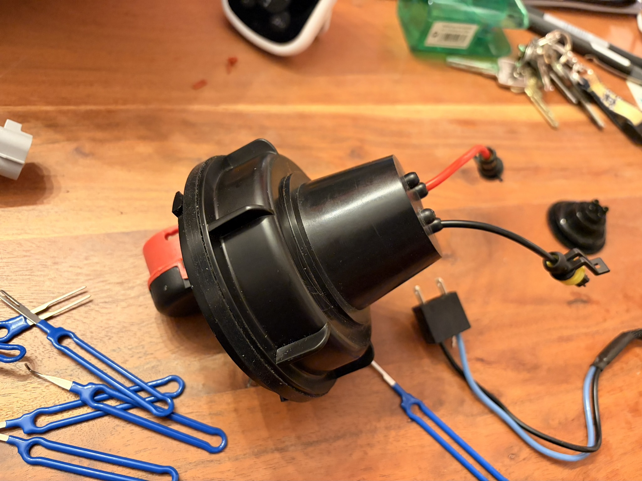

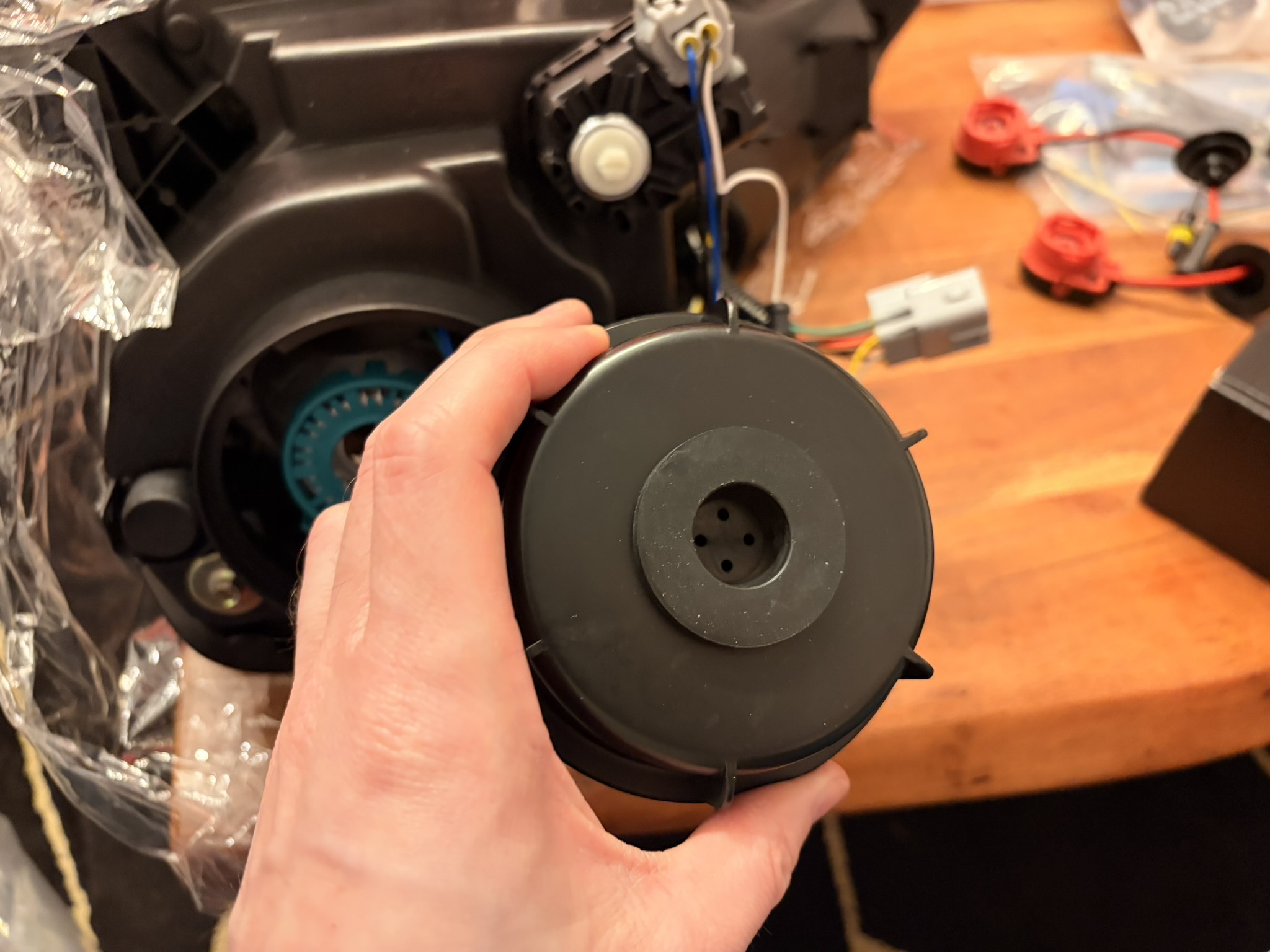

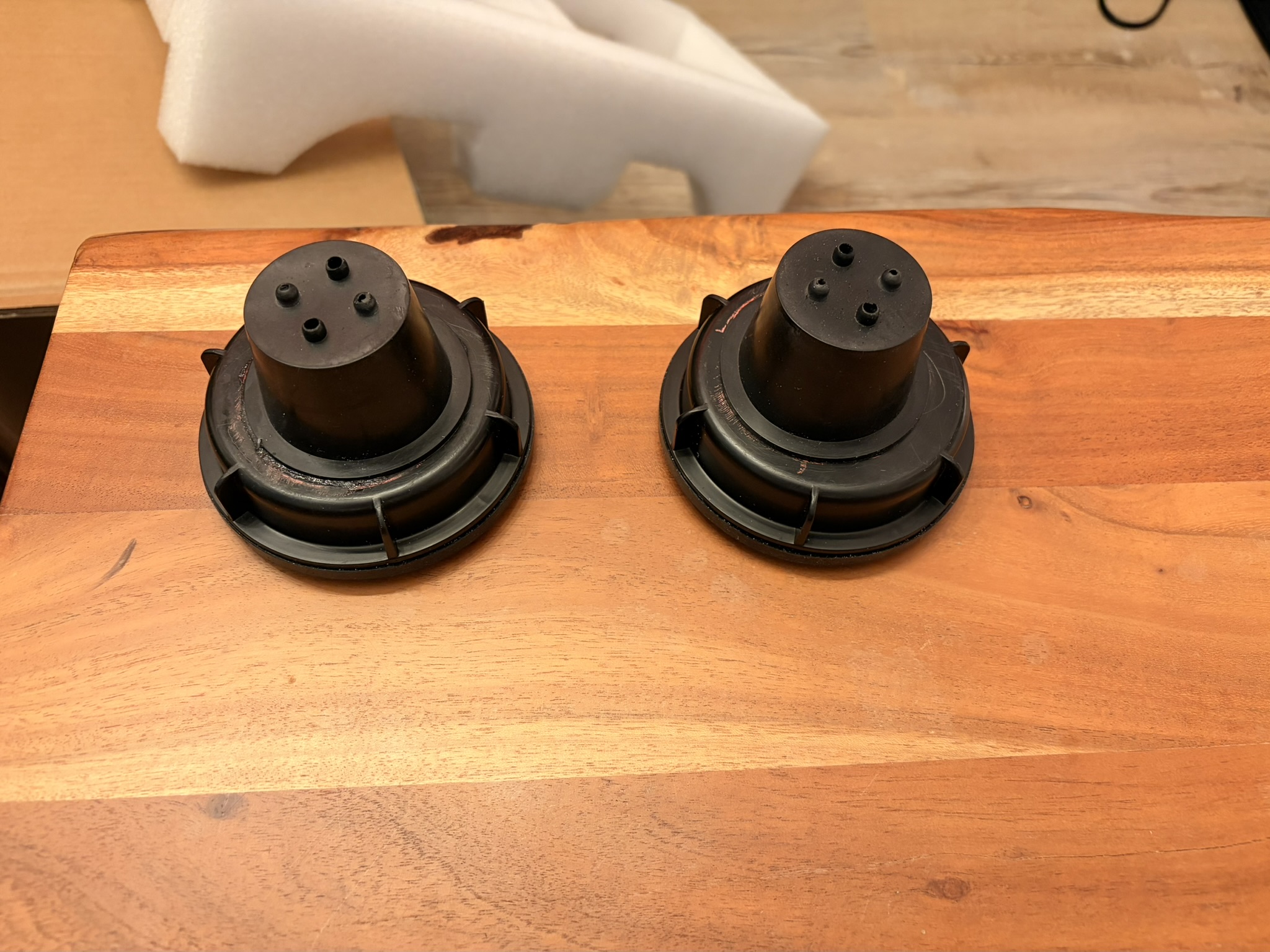

What I did not account for is, that the dust covers would abolutely not fit on top of my Adapter harness.
After some consideration, in the end I modified the dust covers with a universal rubber gasket and routed the wires through it, after removing them from the connectors.
So, finally I had a completed unit, running D2S HIB bulbs.
Nothing like a little coerced plug and play.

I also got a new set of lug nuts, just because "why not?":

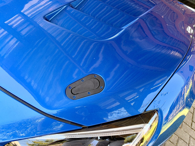

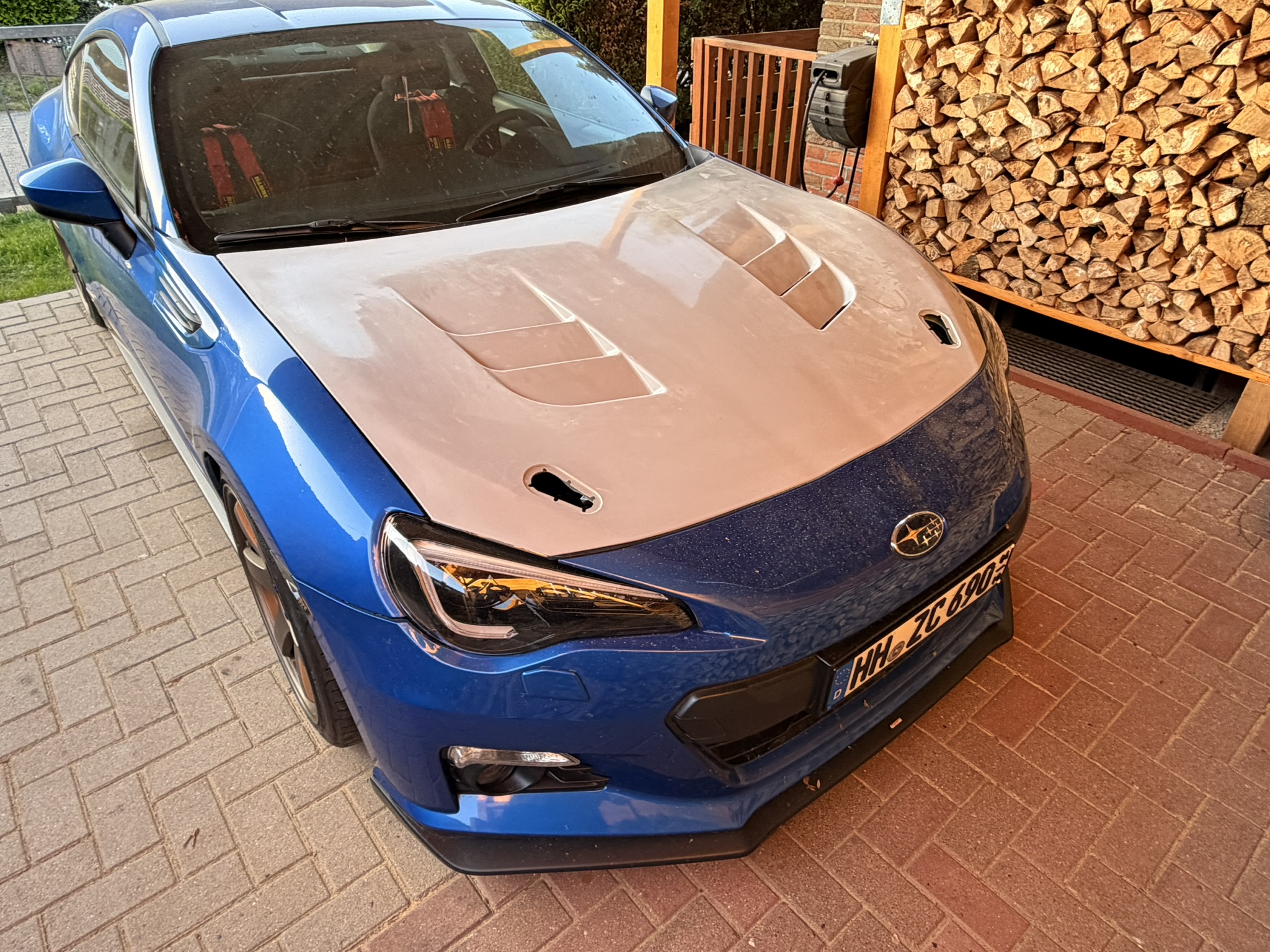

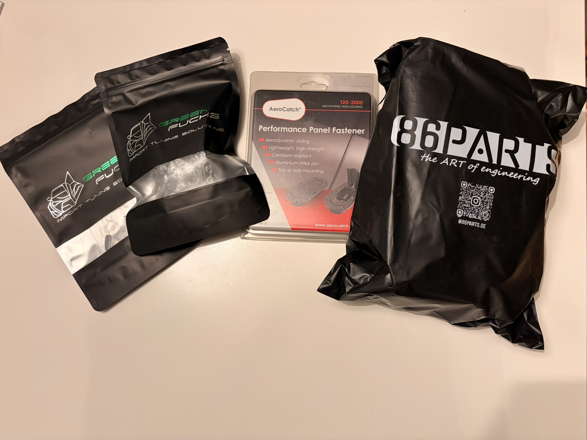

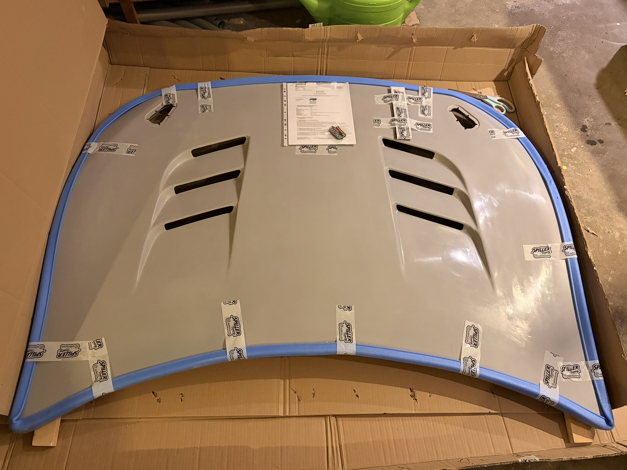

Another, bigger package, next to a few smaller ones, was already waiting in my basement:
Test fitting was a success, so I followed up with the Aerocatch locks:
After I had the hood painted, I exchanged the Aerocatch screws against blue titanium ones from JDCustoms.

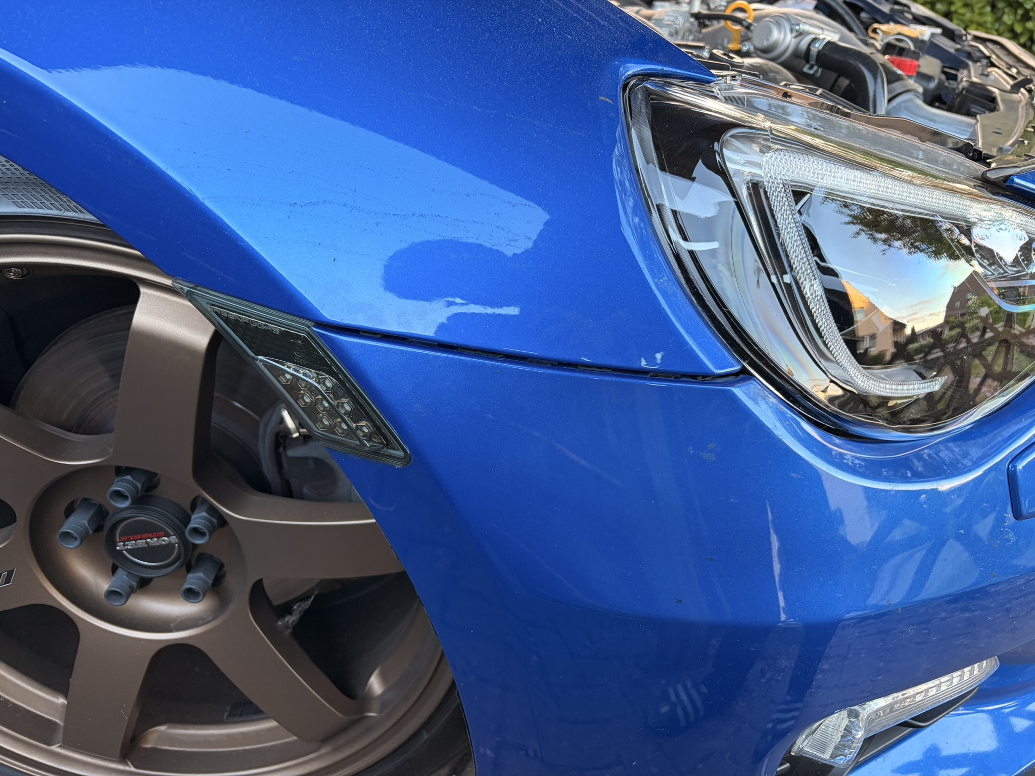

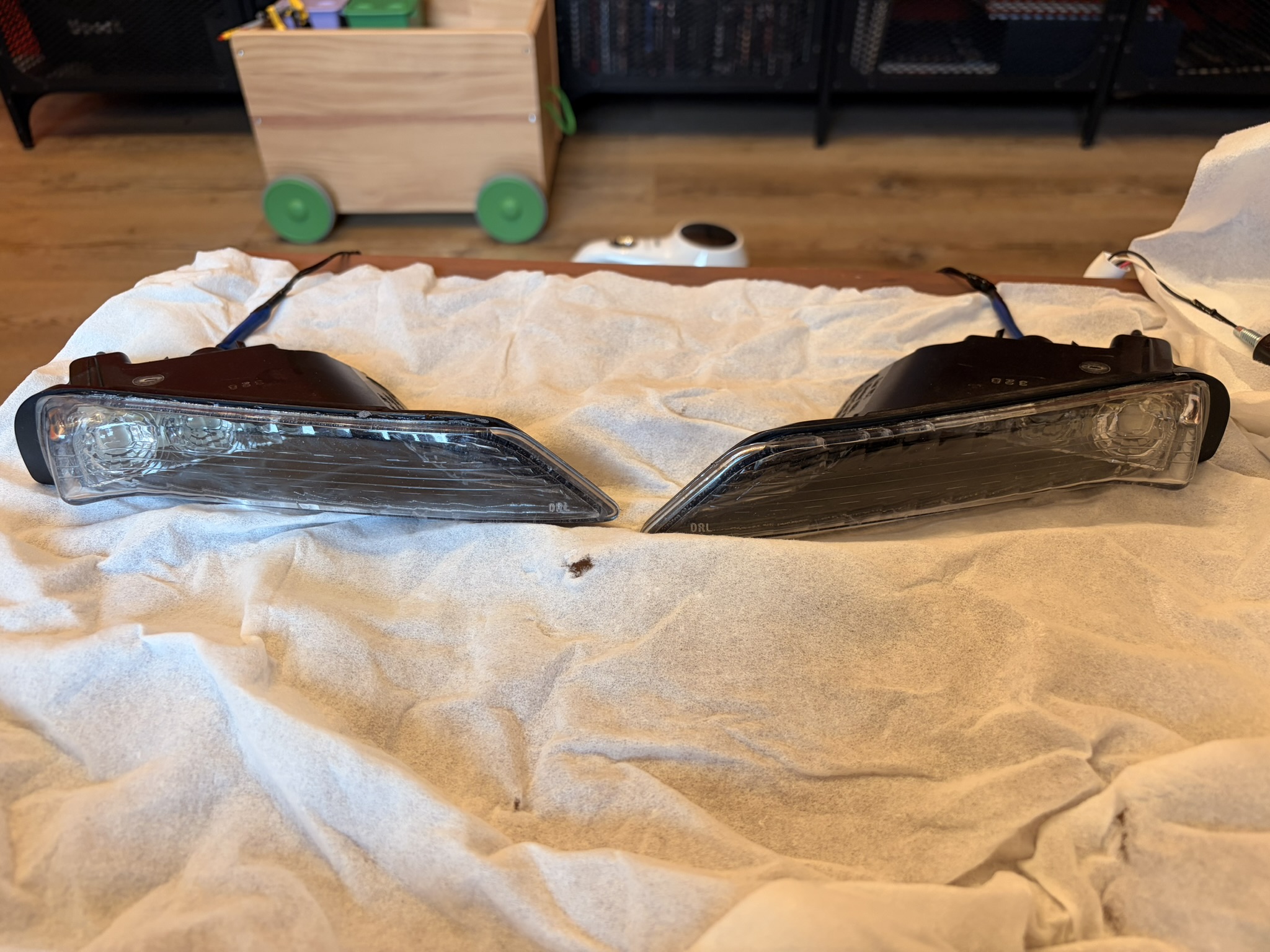

I also opened and blacked out the OEM DRLs to match the black housings of the Vlands and my Morimoto fog lights:
After putting everything back together, I really like the aesthetic of the black housings for all front facing lights.
[IMG][/IMG]

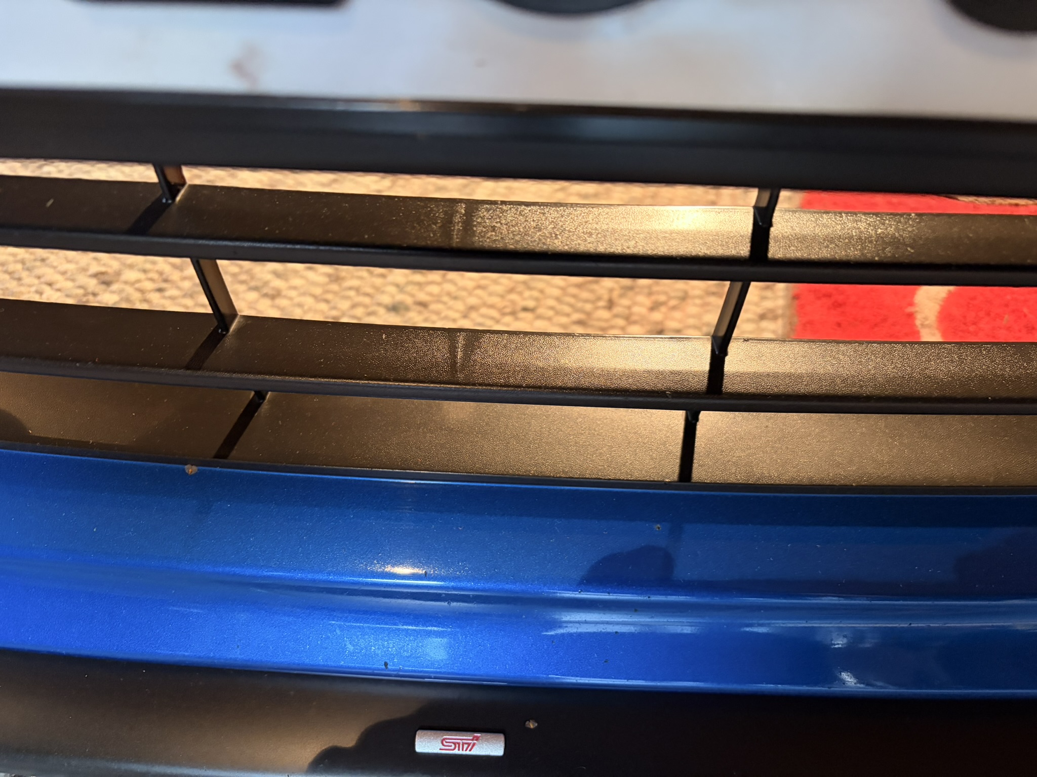

Also used the opportunity to condition and protect all the black plastics, which had started fading over the years:

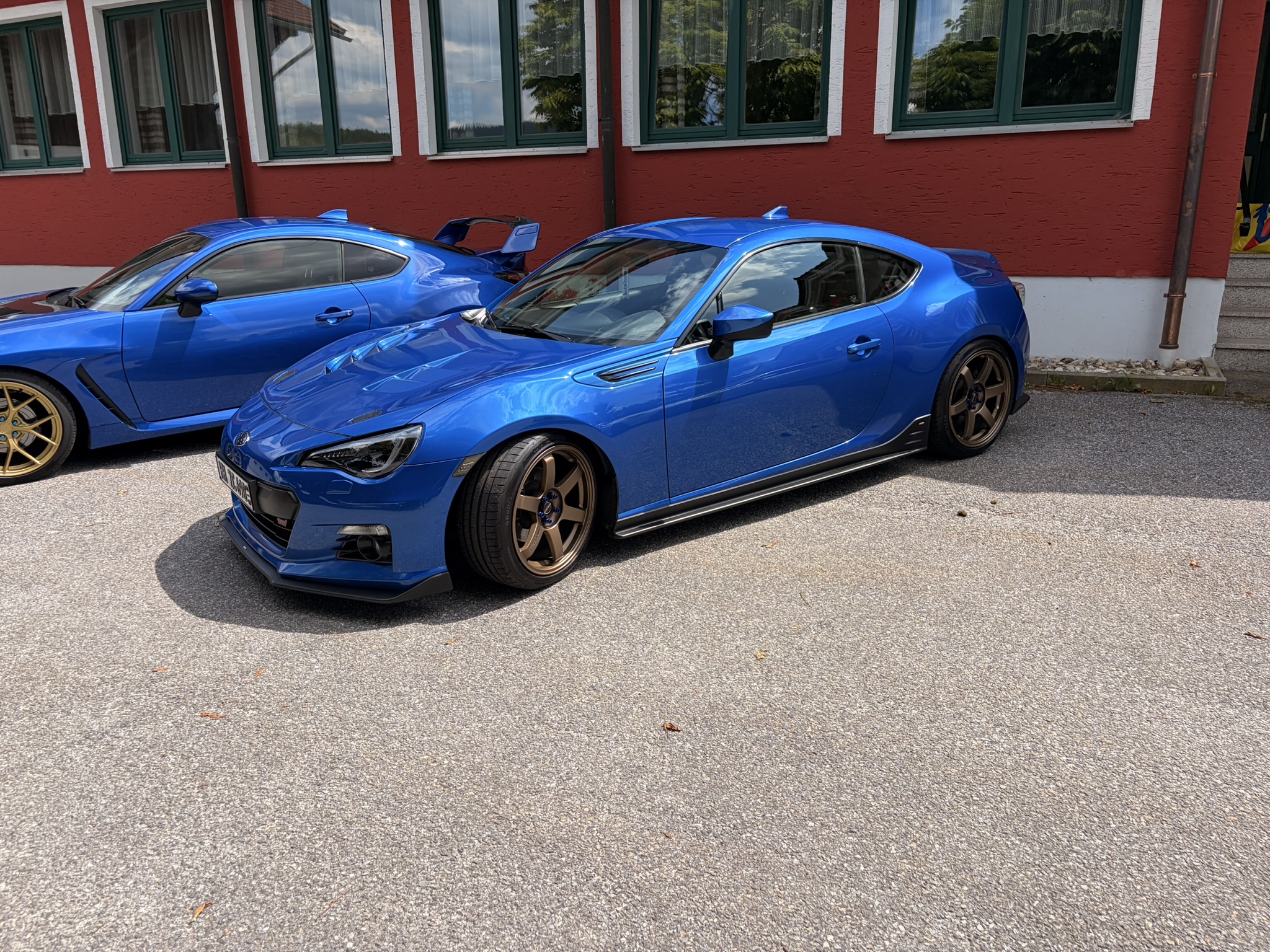

This is the final result...for now
About 290WHP and 345NM. Not too bad, feels like a new car.

Nice build! Well done. Where is the hood from and what is it made of? I like it.
