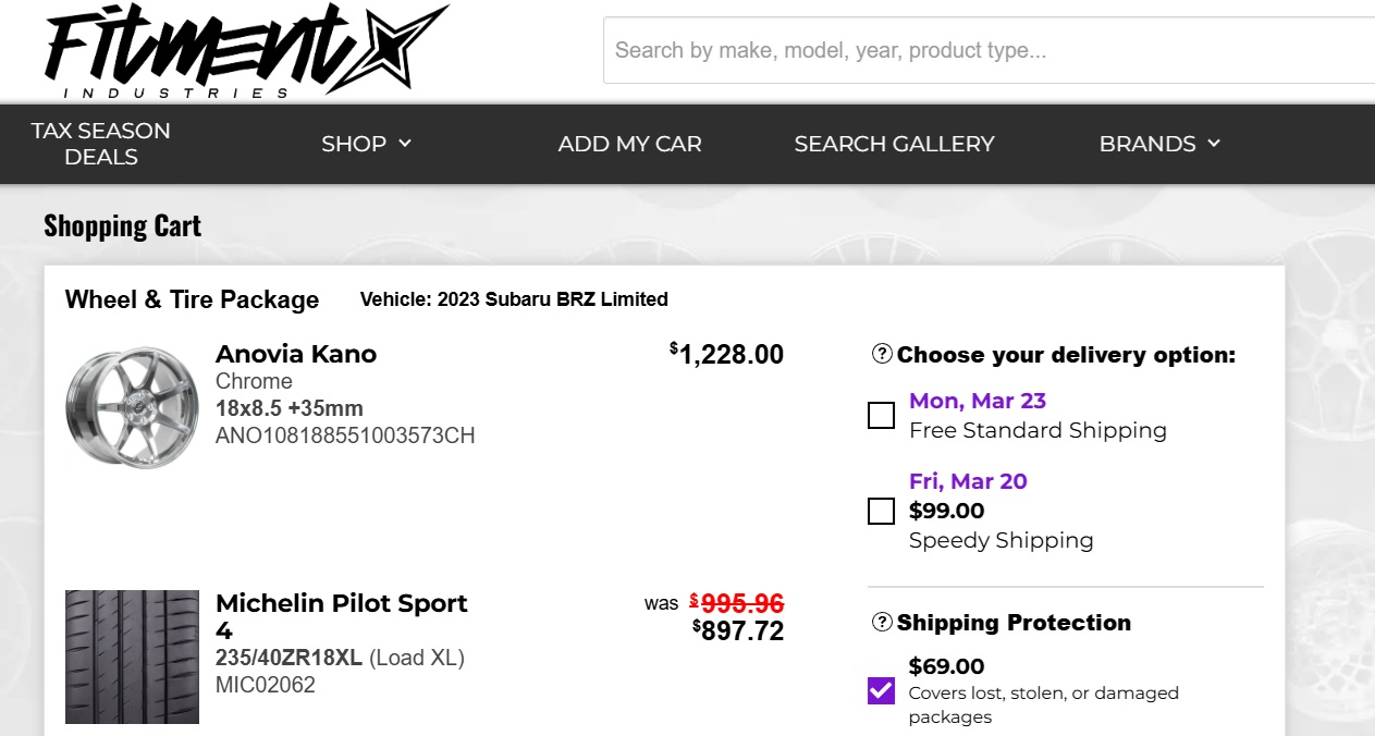

I have a stock 2023 BRZ and am looking at these wheels and tires.
Questions
Will the 35 mm offset bring the wheels out or in more?
Any issues with fitting?
2023 BRZ

Lower number offset = wheel pushed out
Higher offset = wheel more sunken in.
+35 will push face farther out. Rim width also plays a factor in fitment.

Do you think I could go with...
245 40R 18
instead of...
235 40R 18
with 18 X 8.5 +35mm rims
without issues?
2023 BRZ

If you're not on coilovers, 245s are going to be reaaaaly close to your spring perches

245 with 35 profile.
