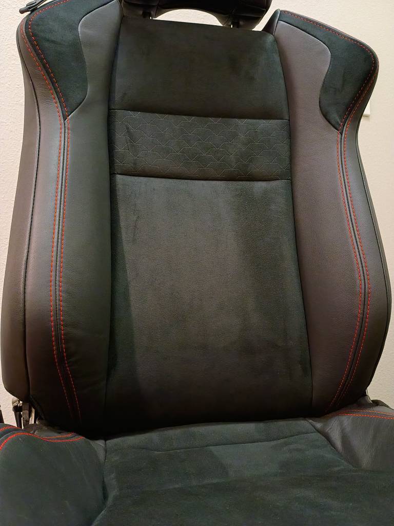

I'm installing my Monogram interior into the BRZ whose condition is 10 out of 10. It was removed early on in my other build then wrapped in plastic for a long time.
I'll likely spray the headliner flat black to go along with the rest of the interior. The BRZ's interior will be mint very soon.
Pictures don't do the condition of the seats justice.
