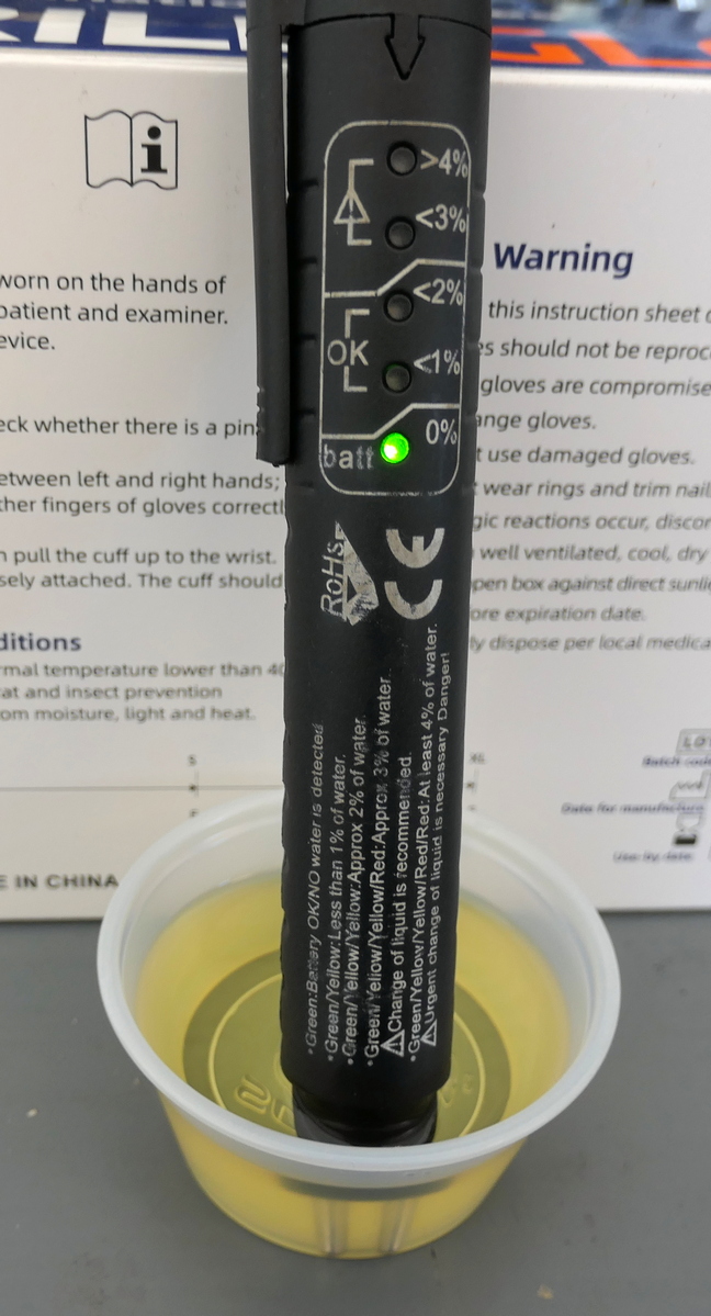

Yeah I know the manual says to change the brake fluid at 30K miles but I didn't. It looked fine, good color, clear, and my cheapo conductivity brake fluid tester showed it had only <0.1% water. Yes, I know they can be inaccurate. I checked mine against a Karl Fisher titrator in the lab and they matched. I have found that they are ok if you use a new alkaline battery.
I put everything back together and the brakes work fine.
