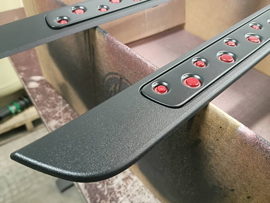

I completed all this work on my 2015 BRZ. I blacked out the interior using flat black vinyl and fabric paint. I had previously steam cleaned the carpet.
**Many other panels painted but not shown. Also added a reverse camera.
Modified OEM shift knob
Removed worn leather, textured and painted shifter and trim pieces. Cleared the top piece and painted it anodized red.
Cleaned up and painted A/C controls and clock (Dupli-Color Vinyl & Fabric paint)
Re-textured and painted center console (SprayMax Texture Paint)
Painted STI push button start trim
Painted shift boot trim and traction control buttons
Re-textured and painted driver door card.
Cleaned up amd painted
Painted tachometer trim
zeal86 is offline   Reply With Quote

I completed a few more things.
I separated and painted the door sills to go with my new interior theme. I finished painting almost all of the remaining interior panels (not pictured).
I also installed door strap pulls and painted the STI intake tube I had laying around.
The only issue I haven't figured out is no power at the reverse light. I have continuity from the head unit through the radio and OEM harnesses all the way back to reverse lights. I'm going to check all the related fuses again and verify whether a bad fuse is/is not the problem, I'll check the backup switch on top of the transmission if the fuses check good.Name:  IMG_20260116_063731389.jpg
