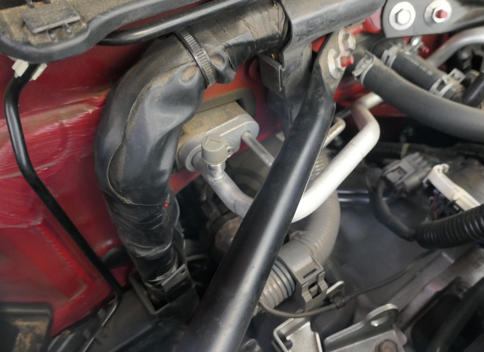

The AC vent air has not been as cold as it should be for a couple of years. Slight leak? My car is 12 1/2 years old so probably. Not sure how much longer I'm going to keep it, so instead of taking it to a mechanic I bought a R134a recharge kit from Walmart. https://www.walmart.com/ip/A-C-Pro-A...R&athbdg=L1300
The low pressure port is close to the back firewall and it's a snug fit getting the kit's connector on.
Followed these instructions: https://acprocold.com/au/help-and-advice/instructions/
Gauge read between 10 and 20 when I connected the hose. Added enough R134a to bring the gauge up to almost 40. Still have more left in the can if I need it.

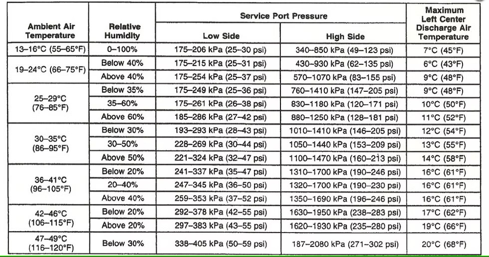

The ambient temp was 85F and 55% humidity. Drove my car a couple of miles and the temp from the top left vent was 47F. The fan was on the number 2 setting and on recirculate.
According to this chart the temp looks good.
