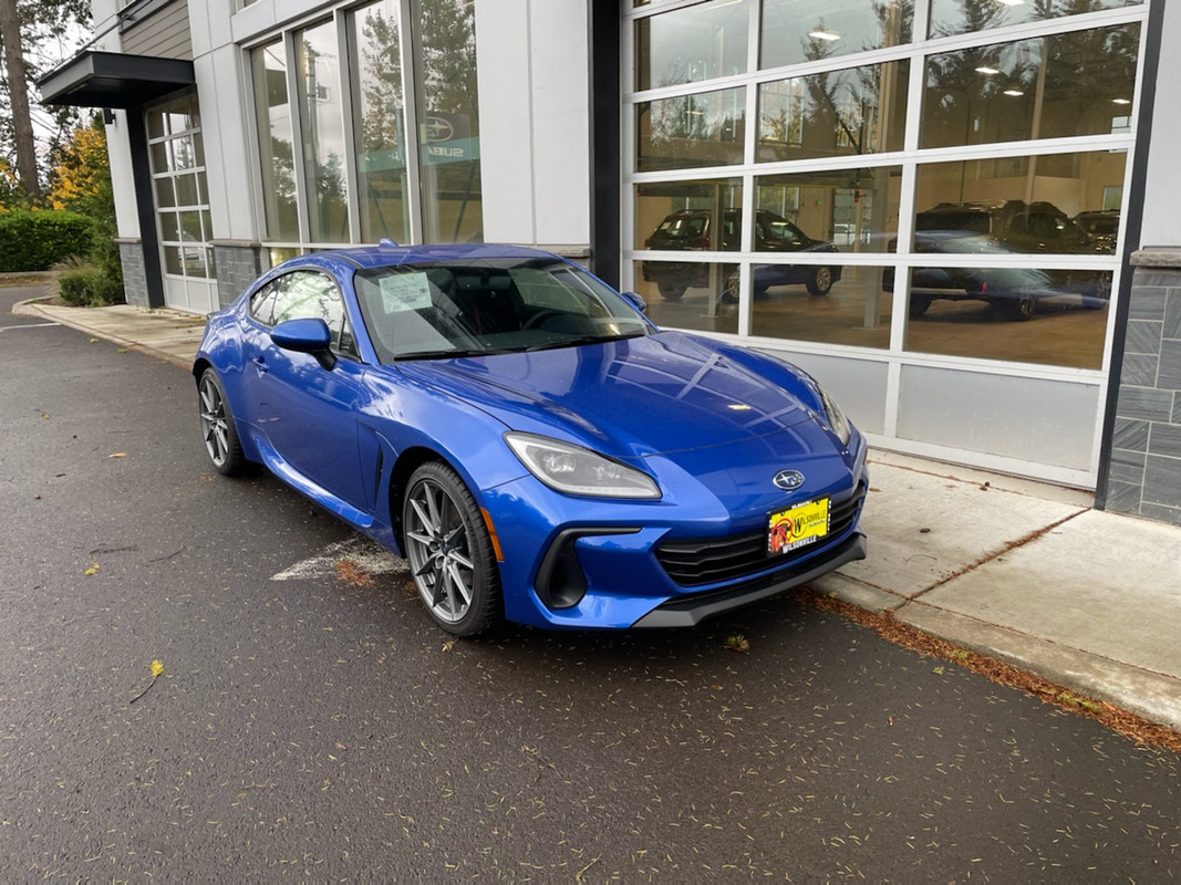

Through work connections I was able to be the first one in the country to take their 2022 home. It was a fun few days waiting for others to pick theirs up knowing I was the only one rolling around in one.
I had an opportunity (again through work connections) to get my hands on a pre-production model in August of '21 to check fitment of first gen suspension parts and verify everything was the same, so I had MCS coilovers and RPF1s ready to go on as soon as I got home with it. So it was looking better after less than 24 hours.

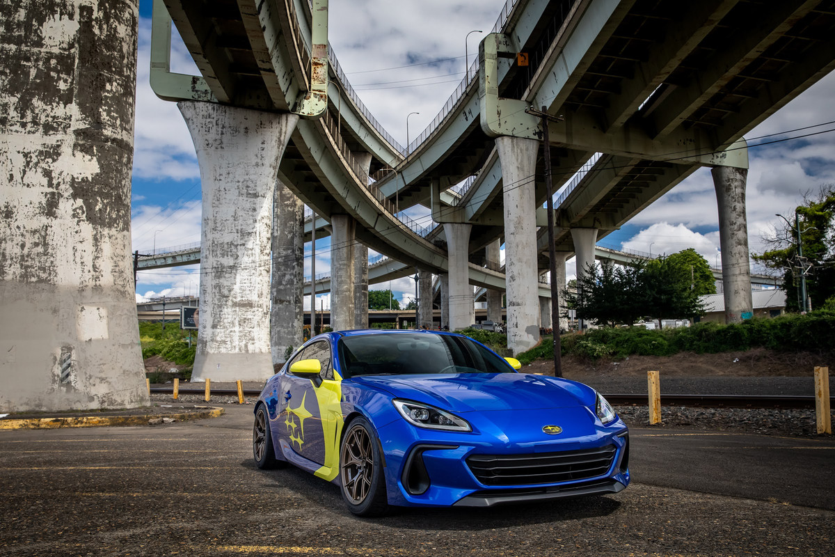

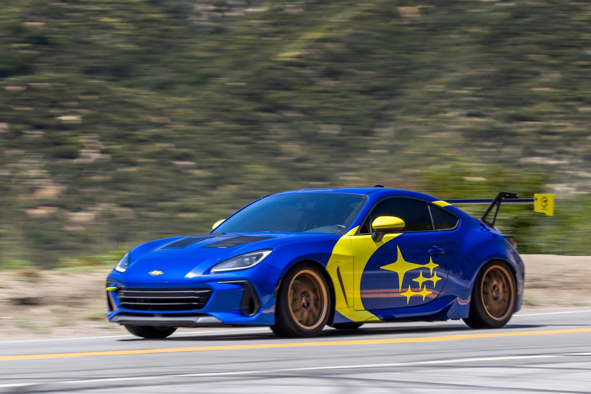

Then I got to some of the aesthetic stuff a few days later and brought my photoshops to life, sporting the Subaru Motorsports USA livery.

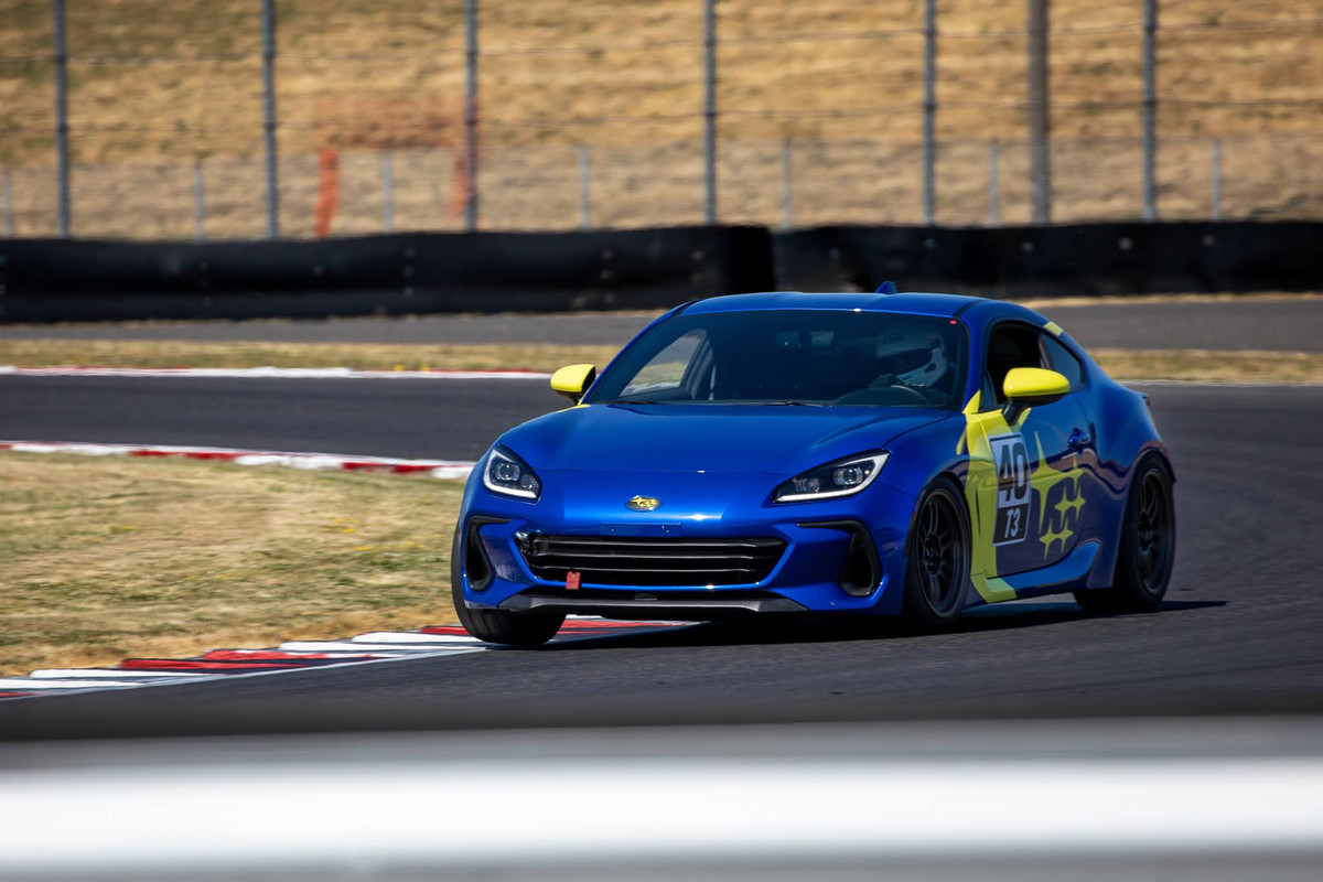

It saw some time trials

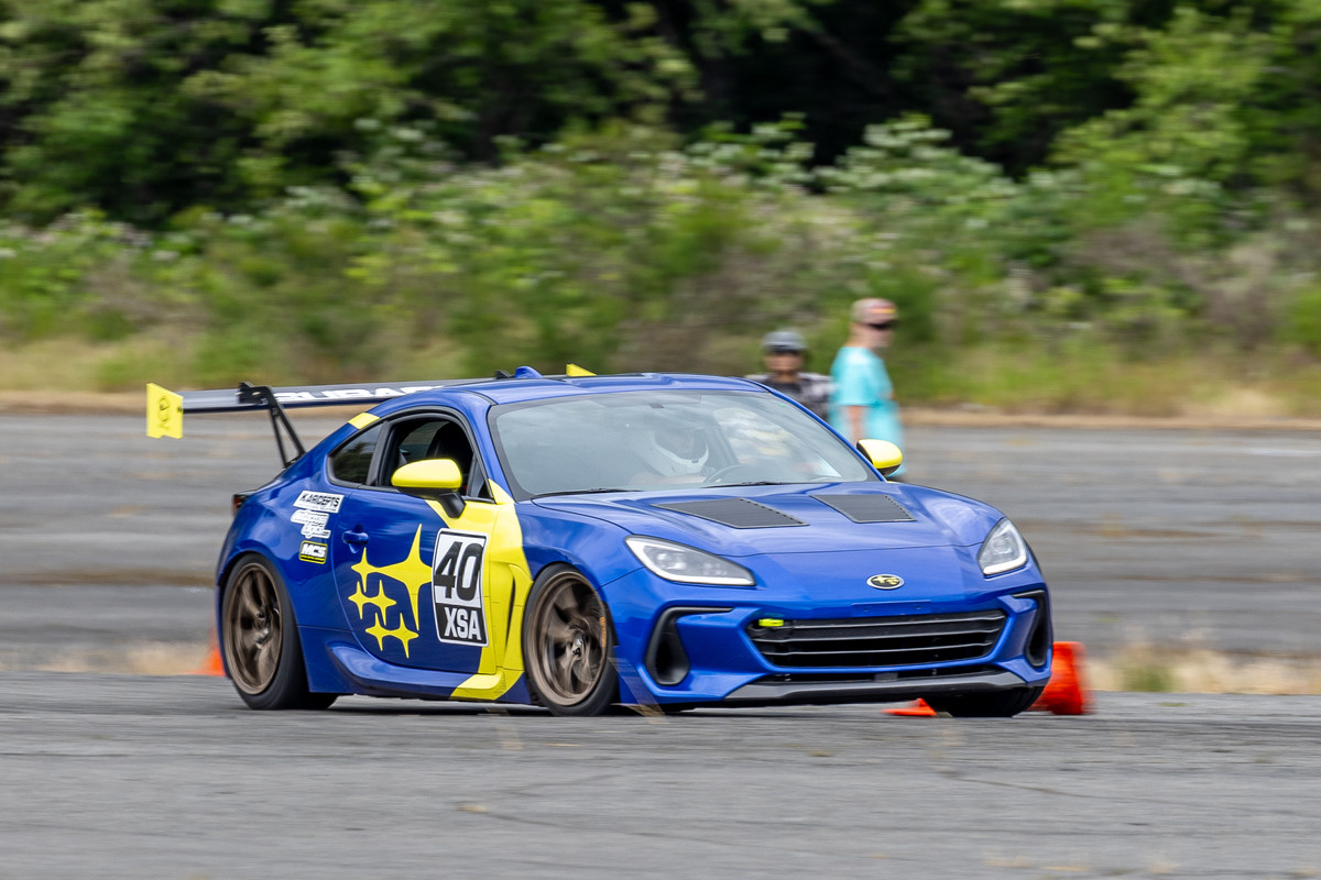

And autocrosses

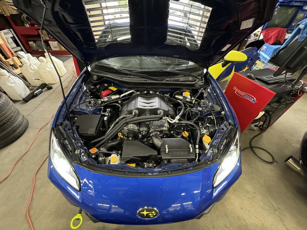

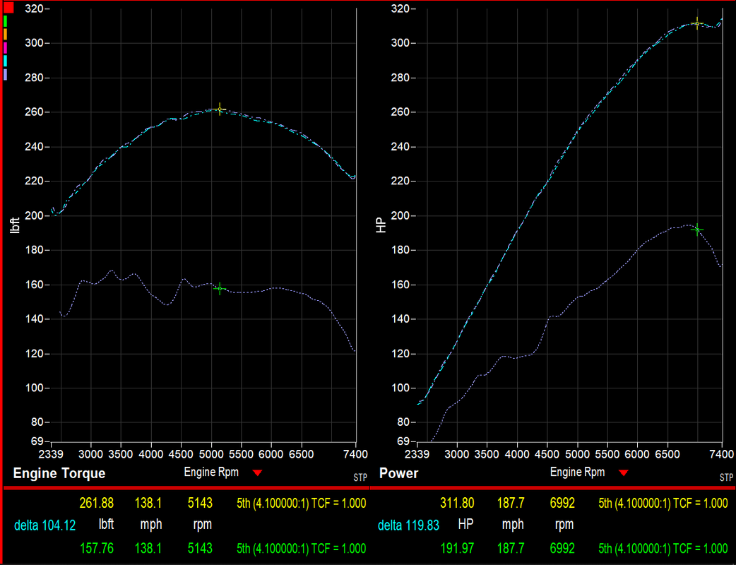

But just a few weeks ago I took it down to Counterspace Garage and had Zack work his magic on a flex fuel Harrop supercharger setup.
On e60, we saw a 63% increase in HP and a 66% increase in torque.

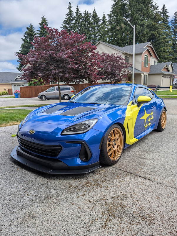

I added some aero:
And then some more aero:

I had the car pretty dialed in for autocross in STR trim, and as soon as I wrote the check for the Harrop, I started in with the extra suspension allowances and did the traction mod first. The car became horrifically pushy and only got worse with the wing. I finally got it out a couple weeks ago for the first autocross since supercharging it and as expected, it was still really pushy. Since then, I went up 10% in rear spring rates, went up a couple steps in stiffness on the rear bar, and did the FLCA's which helped roll center correction. I also added the 4" splitter but I'm not sure what to expect for additional front end grip at autocross speeds with it. So, we'll see if all of that was enough for an autocross coming up the next two weekends. The immediate plan if it's still pushy is to take the last step out of the front bar and go full soft. I'm hesitant to go stiffer on the rear bar until I get the Giken diff.
Here's my first day autocrossing it. It was a bit of a mess but after a heat cycle on the new Yoks, it started to come to life a bit.

Now for driving impressions on the Harrop: it's effing amazing.
I've always been a proponent for these cars not needing additional power and I stand by that. I went with the supercharger over a turbo specifically for the throttle response. I wanted the car to drive like stock, just faster. Zach absolutely nailed that on the tune. The best way I can explain it is every gear feels like one lower before it was boosted. So 3rd feels like 2nd used to, etc. On heated up 245 Yok A052's, it's right on the line of not being able to put power down well. 1st and 2nd are pretty useless even on 245 Pilot Sport 4S's with the traction mod. Honestly my favorite part is that a small tip of the throttle in 5th or 6th gear really exhibits the additional torque. The car just wants to pick up speed even with a small press of the throttle. Zach's flex fuel tune is flawless. I have gone back and forth on the mix several times now without a single hiccup. The clutch is probably the worst part of the car now but I'm finally getting used to it. I've had no issues with water or oil temps even driving in stop/go traffic in 100+ degree heat, and no issues with temps doing back to back autocross runs.
I'm going to have to take a page out of Kyle's book for a custom oil cooler solution as the Racebred splitter brackets kill any chance of putting something in the corner, and there's no room for one to stand upright in front of the Harrop exchanger. So, it'll be awhile before it's track ready again, but for now it's just a blast to drive around town.

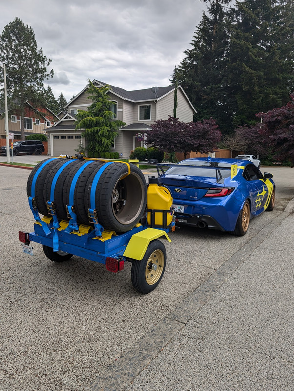

And finally, my uber-nerdy matchy matchy tire trailer

I'd like more info on what you've got the tires sitting on on your trailer. Is that box under them just to lift them up above the fenders? Or do you have a bit of storage going on under there?
I'm planning to just lie my tires down in two stacks of two on the front end of the trailer (looks like same HF trailer) for now to keep it simple. But I'm always looking for better ideas.
Thanks,
-Mike
EDIT: tire tie downs look like maybe this?

Yeah I just built a box to get them up over the fenders. And yeah those are the tie downs.
