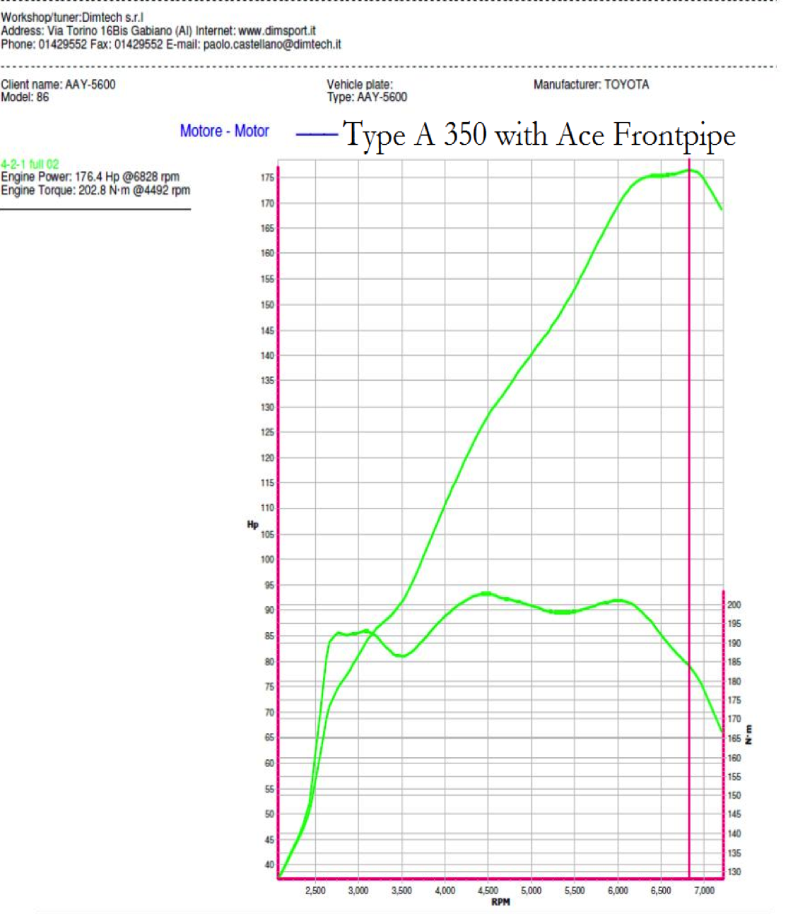

So I have the ACE header dynoed (dyno'd?), but unsure whether I should start a new thread with my thoughts or just dump it here.
93 octane:
E-65 on ACE header, E-72 on JDL UEL header:
Big note about ACE peak numbers:
I did some inspection this past weekend and saw that a bolt was missing from the header to OP connection. Have replaced that and checked all the header bolts, which were tight.
Thoughts:
Peak numbers weren't really my goal, as comparing dynos from different days and different operating conditions can have such varying results. Instead, I want to look at the curve of the graphs. There's some notable things that pop out to me:
* The 3500 to 4500 RPM range yields a notable gain in both whp and tq compared to the JDL UEL. This is great for day-to-day driving.
* The EL sound really isn't as "Honda" as I thought it would be. I did enjoy the baby rumbles from the JDL UEL, but the ACE sounds great at the higher RPM, but the JDL FP and Dezod catback probably help with mitigating any rasp or lawnmower type sounds
* I'm initially disappointed with the peak behavior. The power drops off around the 6700 RPM mark! I'm regularly running 7000-7200 on track, so I'm a bit apprehensive that it dies off so early. I wanted to make sure it wasn't a tuning/tuner/install error, so I checked out some other ACE dynos:
https://www.ft86club.com/forums/showthread.php?t=125559

One thing to note, CSG & Delicious Tuning are the biggest vendor/tuner combo for the ACE set up. On CSG_Mike's 2017 BRZ, the power band builds linearly through 7000 RPM.
https://www.ft86club.com/forums/showthread.php?t=121460
tl;dr / Conclusion:
Because most of Delicious Tuning's customers are remote tune, there's not many data points on how their ACE tunes do, besides CSG_Mike and I believe one other Cali member's plots. Regardless, if one's set on the ACE set up, I would recommend to go through CSG and Delicious Tuning combo.
Now I'd be really interested to get my hands on a JDL 4-2-1 header and get that dyno tuned to compare.
I did some inspection this past weekend and saw that a bolt was missing from the header to OP connection. Have replaced that and checked all the header bolts, which were tight. It's possible the missing bolt made an exhaust leak that, combined with dyno variances, may explain why there's a ~10% difference in peak power :shrug:
Thoughts:
tl;dr / Conclusion:
We spent HOURS of time on the dyno trying to find more power out of these very expensive headers, and all we could find was a couple HP down low, and similar performance that you'd get with any quality header up top. We've had a similar experience with other manufacturers who claim 200 whp on pump gas, even so far as to tell us what cam timings to run to achieve those results--and we lost power by doing that. The difference between a well designed but cheaply made header, and a well designed but well made header is money and durability. There is no magic formula on an NA car to get 10 more real HP out of header design. Eliminating the cat and adding a proper merge collector is responsible for 95% of the power gain with a header (10-15hp), the fancy design work will add the other 5%. Not another 10 or 20 hp.
Interesting, as one of the ways Delicious was pitched to me as the ACE tuner officiando was because of their cam timing optimization. My tuner went so far as to review his "secret sauce" tables with me to show that there really wasn't any more timing or ignition that he felt comfortable adding, yet that's what the power and curvature would stay at.
You haven't had a chance to dyno tune any JDL 4-2-1 set ups on this platform yet, have you? I'd be interested to see if characteristics are similar.
I'm very curious about the answer to that too, as I'm still split on JDL 4-2-1 vs ACE. Honestly once all is said and done the price differential isn't that big by my calculations, but I am curious how close they end up being.
The cams have a usable swing of about 20 degrees at the high end. I.E. you wouldn't run 40 degrees of cam advance at 7000 rpm, but best power will be somewhere around 0-20. It doesn't take long to do a sweep in 5 degree increments on both the intake and the exhaust cam to find the optimal timings. We have not tested the JDL 4-2-1 yet here, but we'd certainly not mind. Looks like a nice unit as usual.
