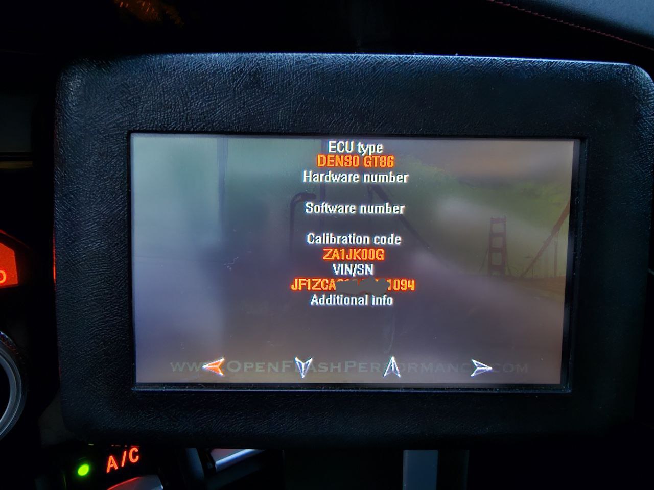

Ordered tune files from WayneRoms and picked K00G as it's the one showing on my OFT
But after downloading the .bin file and trying to add it to OFT, I am getting an error The selected file is not compliant.
Scrolled up a bit on OFM and saw that the CAL is showing as N01C
Emailed WayneRoms via their Paypal email (Only contact info i can see on the site) and currently waiting for their response but hoping someone could help me out on this?
Thank you!

To explain why, all OFT roms (including Wayne's) are Cal id hacked.
OpenFlash only uses 4 tunes in total and those are:
2012-2016
ZA1JA01G (MT) and ZA1JA01I (AT)
2017-202x
ZA1JK00G (MT) and ZA1JK00I (AT)
Those are Eurotunes and used because those are the easiest to work with and most defined in the definitions.
The tablet however marries itself to the VIN number and the Calid, that's why you will see (in this example) ZA1JN10C while up/downloading files but when reading the ECU itself it will show the real Calid (ZA1JK00G)
So for anyone who is questioning which Calid he needs to flash tunes, just look at the up/download screen.
Bonusinfo:
This method will create problems when trying to edit the OpenFlash/Wayne tune yourself.
You need modified definitions, In this example you will need definitions for ZA1JK00G, but modified to look like ZA1JN10C, Using 'real' ZA1JN10C definitions with the OFT tune will most likely brick your ECU when flashed.
