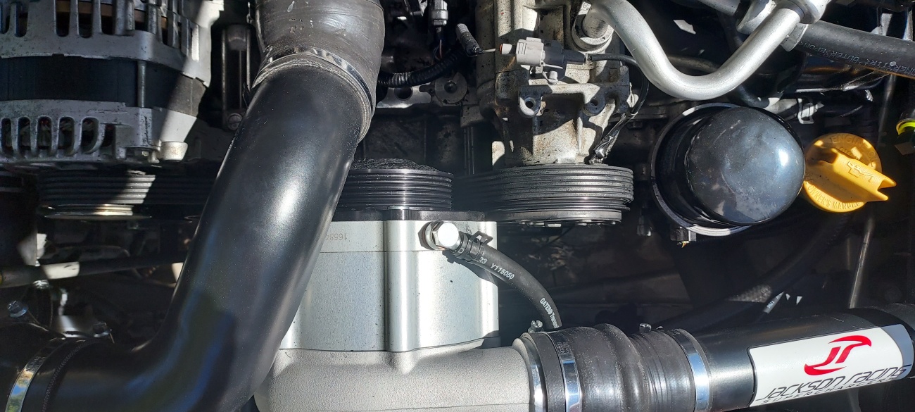

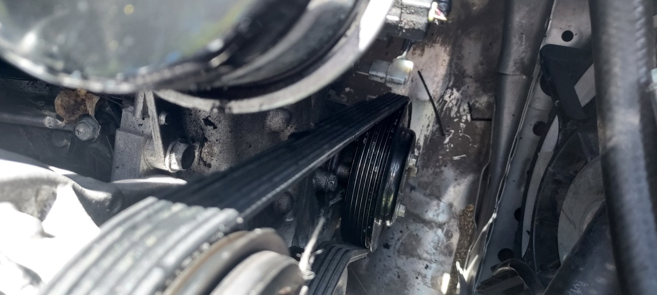

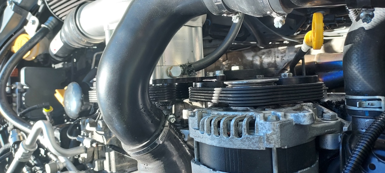

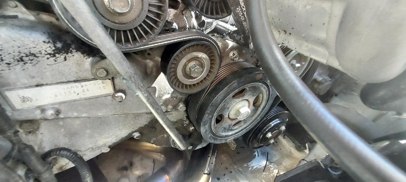

Hey guys I'm kind of at my wits end with an issue that popped up after moving from the supplied c38 pulley to the high boost pulley.
A little backstory: I just boosted the car towards the end of June and ran the original pulley until I moved into flex fuel/high boost pulley around mid august(no issues). About a month into this high boost pulley install my car began hopping belts out of position and peeling off strands like a Twizzler and now I'm 4 belts deep. I did the install with a mechanic friend as I'm basically only a youtube mechanic at this point.
After the second belt shred I had my local tuner and a local Subaru specific repair shop check belt alignment position. Both told me everything looked okay and it might be worth getting a new tensioner arm(video of tensioner movement below) as this one had over 90k on it. Ran 3rd belt for over a week without issue when it hopped a groove and walked itself off the lip of one of the pulleys during rain.
Today(3 days after placing 4th belt on) with a brand new tensioner arm the belt hopped and walked out after hitting the rev limiter merging onto highway.
I've been in contact with the JR team and they've reassured me this has never been an issue in the 12+ years they've been in production. I'm either patient zero on this problem or there is something really wrong that experienced eyes haven't been able to pinpoint. So that's why I'm here. Does anyone here have any experience or advice? Do I need a shorter length belt with the high boost pulley? Do I go with aftermarket Idler pulleys to add extra walls as a means to keep it from walking? Is it a sell the car(kidding) angle?
Photos/video links below

Is your supercharger bracket flat? Put it on a known flat surface, like a mirror, to verify.
Any aftermarket pulleys?
Hitting the rev limiter WILL cause belt issues. Don't do that.
Also, you can run a slightly smaller belt with the HBP to maintain better tension.

All pulleys on the vehicle are either OEM or supplied via the JR kit. I am sitting on NST tensioner/idler pulley kit but haven't made the move to place them as I just wanna know why its happening before complicating the process.
I'll be looking over the bracket to make sure its flat once the new belt comes through shipping.
I know hitting the rev limiter is generally something you're not going to want to do but at the same time I shouldn't be terrified that bouncing it once will cause it to completely derail.
I'll update as soon as I begin pulling things apart. I'm thinking its most likely an issue keeping tension through the rpms.
