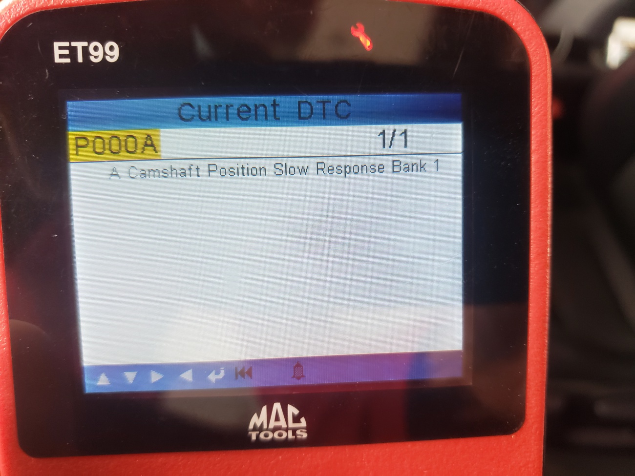

2016. CEL and SL both popped up just this morning. Idle bounced between 900rpm and 1000rpm for several seconds when I started, eventually settling down after throwing both CEL and SL. Engine has about 6500 miles.
Code is P000A
