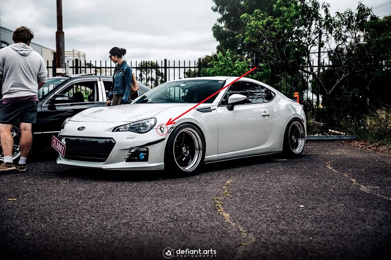

Originally Posted by fuddbutter View Post
Had mine in for 12+ months now, no issues at all.
Hey Fudds,
What is that thingy?

Hey Fudds,
I think it's this thingy
Holds my bumper up, and didn't cost me $350!
$15, couple of nutserts, stainless bolts and bam! I can now join the rest of the hardparker car racers kids with their quick releases!

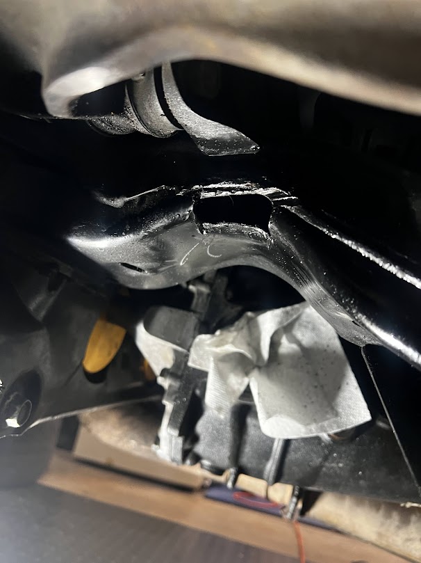

Hi, I got the risers from PSM
https://store.partsshopmax.com/shop/...s/ZNC6SDR.html
Im debating between installing them myself or taking it to a professional, would you be able to estimate how long does it take to mount the risers? including taking the diff out
and most important, did you need to notch the subframe, and how much drop you have? I will be lowering ~1.4 inch with KW v3, really hope theres no need to notch
The install isn't too bad, but you probably need a press or air hammer to get the old bushings out of the diff. I did end up needing to notch the subframe. Not sure how much of a drop I have, but my rear 235/40/17 tires are just about even with the fender. The axles also were rubbing on the upper control arm, which I let self clearance I attached a pic of my subframe trim.
I don't recall exactly how long it took, but I'd say probably 6 hours from tires up to tires down. Here is a reel I put together of the install:
