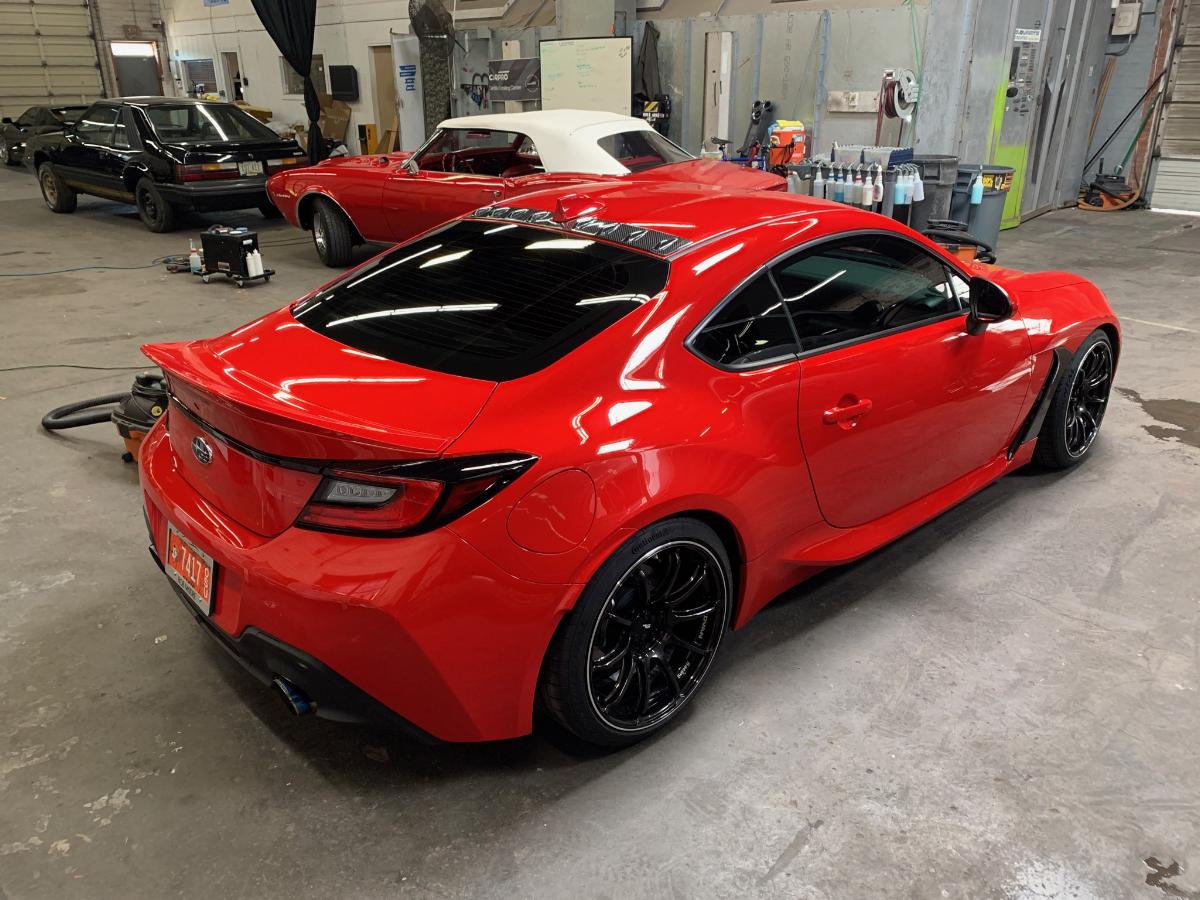

To update, since this was bumped.......forgive me if I missed what tires you are running.
I'm 18x9.5 ET45 with 245/35 Conti ECS, -2 in the rear, no rubbing, but I think it's right on the edge of what will fit under unmodified fenders without becoming a tilty wheeled frittata. This isn't a great pic to show it, but if you're right behind the car looking, the edge of the wheel is nearly lined up with outside of the rear fender. The front could use a 10 mm spacer to look better. The vortex generator and fender vents are APR CF, not the knock off stuff.
