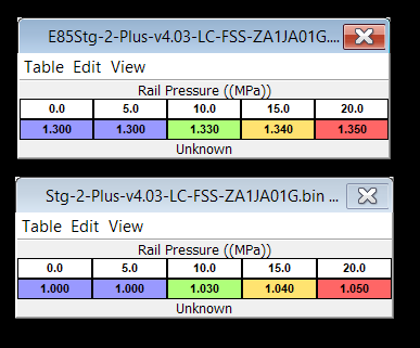

There is an adjustment needed, but the latest oft roms should have it already. It's needed because the mileage display is based on fuel rail pressure which isn't changed by an e85 tune. It's called fuel display multiplier offset in my RR definitions, under misc.-other.
