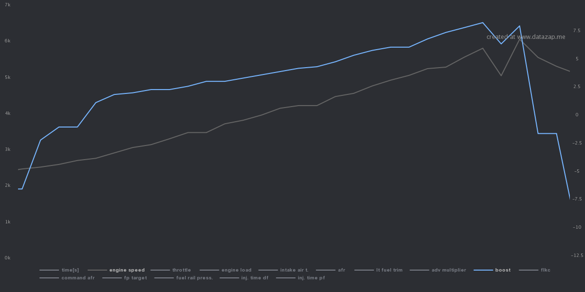

This boost cut mod is working pretty well!
I modified A01E CAL ID rom file for this boost cut mod and got good result.
Boost cut activated at 8 psi and deactivated at 7.5 psi.
https://datazap.me/u/makinenkr/20180...zoom=2728-2758
It might need fine tuning of parameters to prevent boost fluctuation.
Good job @ztan !
Attachment 161593
Good job @ztan !
Nice work,
you could likey just use the entire A01G rom in your car and get flexfuel as well
