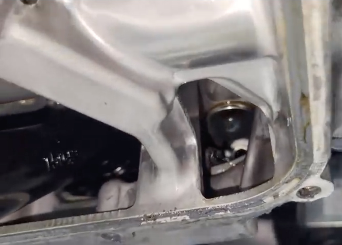

Gen1 vs Gen2 upper oil pan
Its really the design of the upper oil pan/oil pickup (not timing cover) that's the defining difference between the oil sloshing movement on track. the first 2 pics on the Gen2, you can see that there's a huge void in the upper oil pan as well as the way the oil pickup is skinny right where it goes into the timing cover that provides a huge passage for oil to move into.
Compare that to the Gen1 picture (my car with killerB pickup) the giant casting and giant oil pickup mating surface basically blocks the majority of the pathway for oil to get into the timing cover. The casting and mating surface of the oil pickup is also at a lower level (mating surface level of the lower oil pan) which would act as a lower baffle just by itself.
FrickingReallySlow is offline   Reply With Quote
Sure.
Just trying to understand what going on. Because it does look like its not the FA24D timing cover as detailed by Subaru anyway. The upper oil pan is a little more difficult to properly match from the documentation as its a weird angle, but it looks far more similar (even though they do note a few changes to it as well).
Blighty is offline   Reply With Quote
