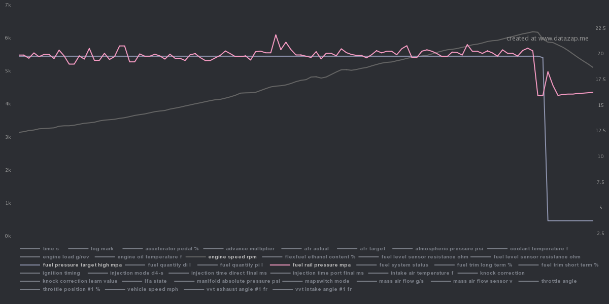

Originally Posted by AussieBRZ View Post
Yes seems strange usually di fuel pressure failry steady 3 to 4 MPa at idle
Check the grounds on the DI computer under Bonnett all three bolts in and tight
Also it might be the di fuel pressure sensor feeding the di computer weird info then the di pump tries to follow that.
My guess would be di pump or di pressure sensor if the di computer is correctly earthed/grounded unless there is something very weird in tune
going to look into this, thank you!
the bottom bolt on the injector ecu was loose! But it didn't fix the problem
Going to replace the hpfp and see if that fixes it. If not I'll pull the IM again and swap the sensor.
Tuner seems dismissive of the issue and I feel like my fuel trims are high and afr seems inconsistent at idle and cruising IDK

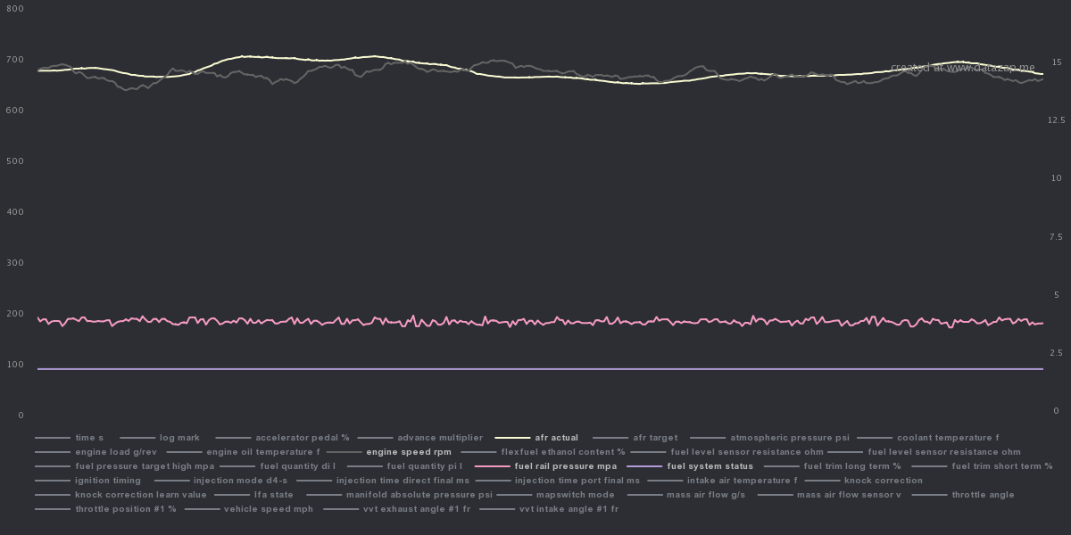

Check the bracket bolts on di computer as well see photo
remounted the injector computer and checked those bolts, super snug.
Start car up and fuel status stays in mode 2, once it drops to idle it does the fluctuating between 2 and 4 and the ticking starts
Is it possible I boinked a wire when I moved the injector computer to remove manifold?
When I go to check ready states fuel sytem is unready which I find odd so I don't think it will throw a code?
Could it be my e85 flex fuel kit still being installed?

Not sure where this is going so I'll just throw this out there.
It runs well enough to go closed-loop mode while idling. The trouble starts when it tries to switch over to DI. That is something the ECU does to minimize emissions while idling. It goes into a lean-running mode with only the DI enabled.
I wonder if it can't switch to DI simply because the DI rail pressure is not being regulated. That sawtooth pattern seems to me like it's hunting because of inability to control. Since pressure reading is there and seems reasonable, I'd go back to suspecting the spill control valve, or the actuation signal.
Again... I've no firsthand experience with this. I'm just thinking out loud about how I would approach the issue.
I get new pump in next week I think, so can try that.
What is odd is that when driving around it seems to hit requested values, it just seems to be all over the place idling.
