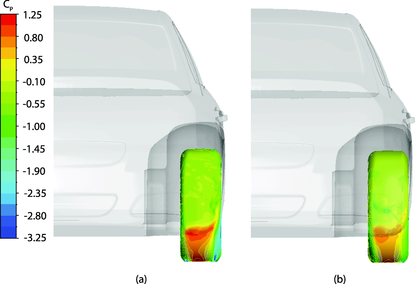

It's aero
https://aia.springeropen.com/article...74-021-00086-7
One commonly used passive flow-control device is a wheel deflector which is placed upstream of a rotating wheel, causing incoming flow to yaw prior to reaching the wheel and thereby altering the stagnation point of flow on the wheel.
