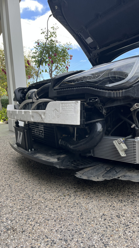

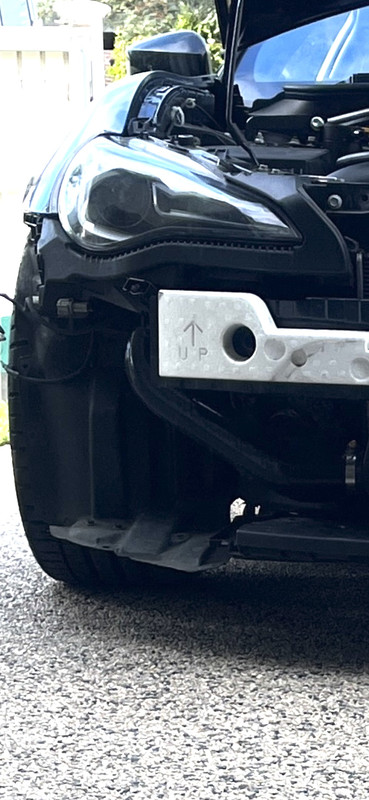

I have the g25 550 kit with the mishimoto oil cooler. I have a large splitter and aero lip.
Intercooler is in the way of the bracket location of the cooler, and the cooler itself is quite tall and can’t fit under the crash bar because of the fittings. Mine is mounted as far front as possible which ended up being right behind the grille (touches it) with the bumper on. Could really go a few MM back for better bumper Fitment but will need to make an angled bracket for the cooler to do that.
I’d suggest looking at the AVO oil cooler than mounts on the driver side behind the fog light. Lots of space they’re not taken up by anything.
That’s where I wanted to mount my cooler but the mishimoto lines were only long enough for a front, centre mount
Keep in mind bumper didn’t fit with placement in this picture, had to move it back about 3-4cm

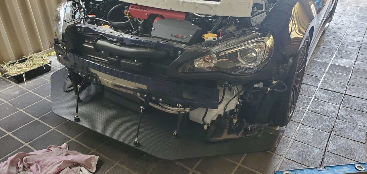

AVO Oil Cooler ducting wont work with the SME intercooler piping. (SME has their intercooler piping below, while AVO has theirs up top which allows the ducting to slide under it.)
I still don't think that side mount location would work with the Verus splitter, as it has a rod that goes straight to the same location as what seems to be an auto trans cooler on yours.

The AVO oil cooler is the same bracket just reversed as my AVO transmission cooler. It’ll fit fine just obviously not with the air duct that comes with it.
Looked at your photo, the rods don’t appear to be in the same position as the cooler so you’ll be fine. The cooler sits on top of that far right bit of underbody plastic
Lots of free space as you can see, just have it mounted at the bottom and angled slightly the same as I have done with the transmission cooler
