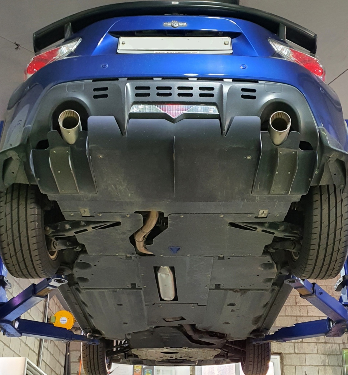

You can see the holes in the rear bumper.

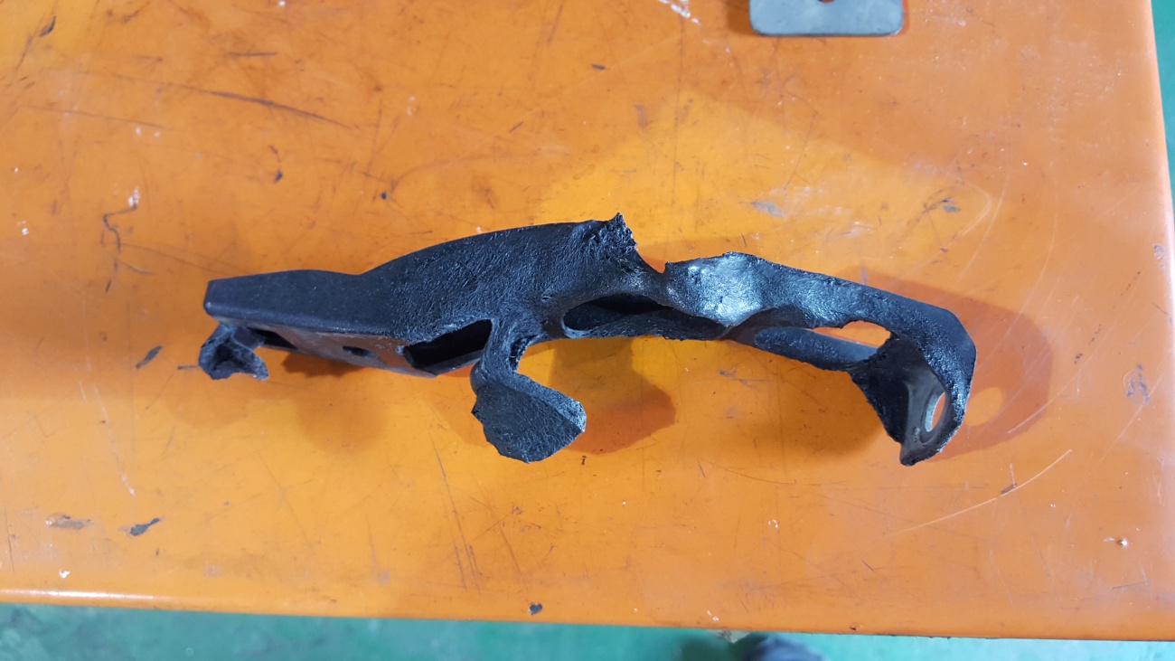

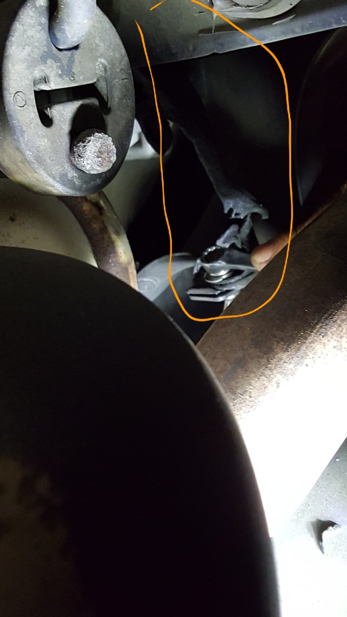

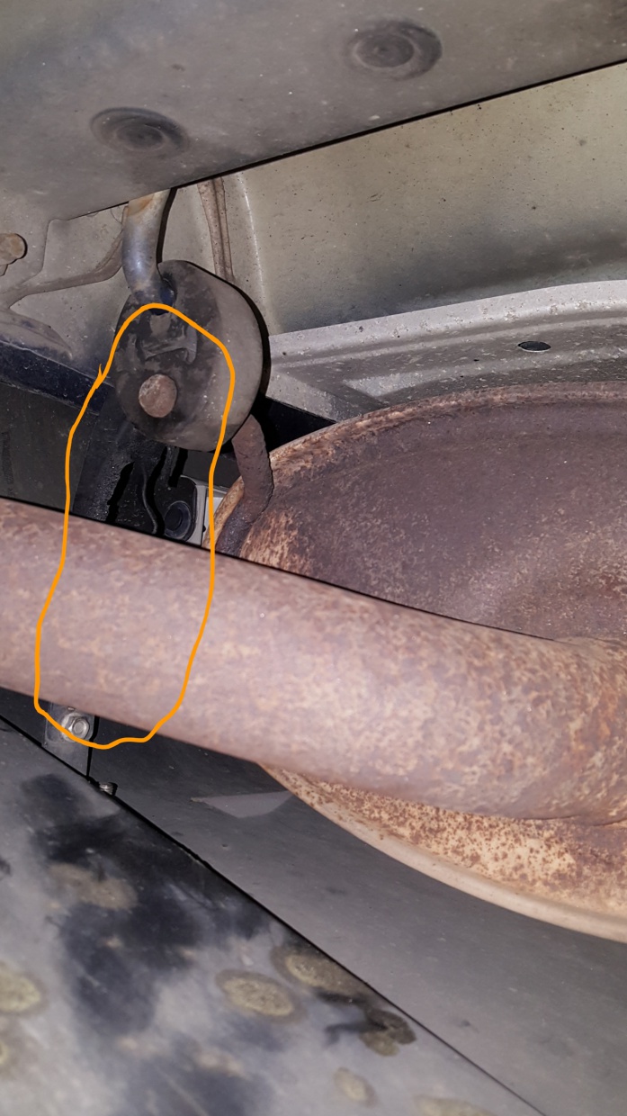

There are chances that hold heat inside the rear bumper space. So I made holes to escape heat out of that space.
The connector parts that hold the bumper skin to the chassis were toasted before making those holes.

This issue could be caused by my diffuser design which has little air escape except muffler tips.

Is that NACA duct for the diff?

Yes, it is 3D printed one for diff cooling.
