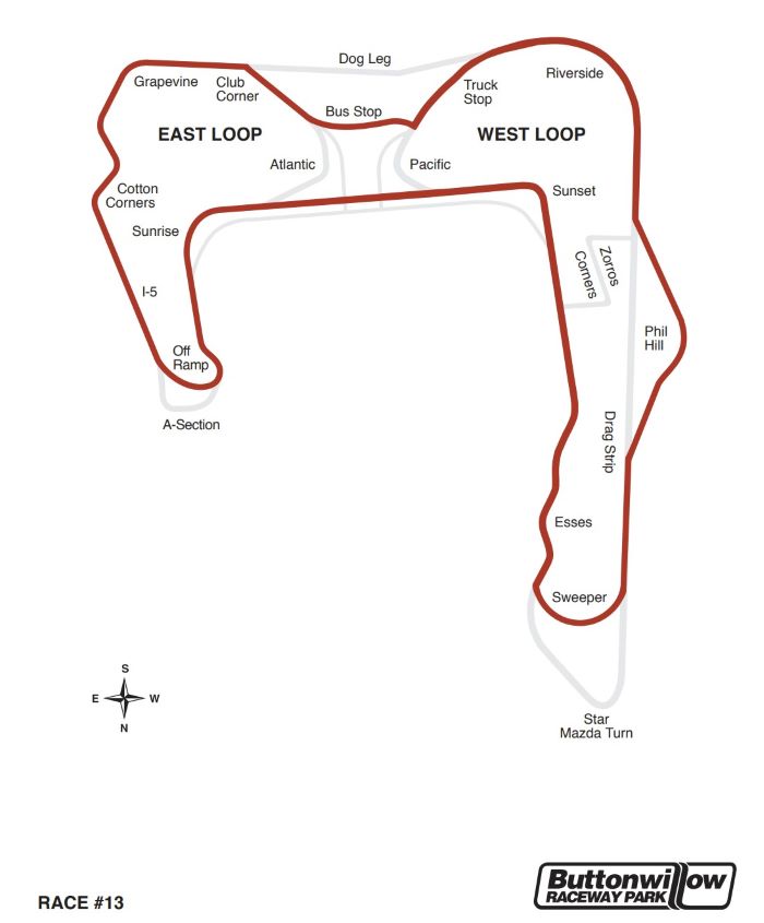

If you are familiar with Buttonwillow 13CW layout (see the map below), all the turns that has oil pressure drops marked in the image are right turns. And the pattern is quite similar, it starts with a hard braking and a right turn with more than 1g lateral.

* Turn Off Ramp: With baffle, it looks like the pressure is even slightly lower to 22psi. But I am not too worried about this turn as the RPM dropped below 4k and pressure recovered before throttle increased.
* Turn Club Corner: Pressure dropped for less than 0.5sec and with baffle, the minimal pressure is marginally improved.
* Turn Riverside: Oil pressure is oscillating regardless of presence of baffle. This is a 6sec 1.1g right turn with a little bit positive camber. However, unlike other turn marked here, the car enter the turn with throttle instead of braking.
* Turn Phil Hill: This is a right turn with hill top. With baffle, the minimal pressure is improved from 30psi to 40psi. The pressure drop lasted for around 1 sec.
* Turn Sweeper: This is a long double apex flat right turn with around 1.1g. Oil pressure is oscillating regardless of presence of baffle.
So, yeah, the syms oil pan baffle (even though it is on Japan's 86cup approve list) doesn't seem to improve or worsen anything, at least at Buttonwillow CW13. But the pressure drops at BW is also not as bad as what I seen at Thunderhill West, where at T5 the car dropped to 30psi for around 5 sec.
Doesn't the pickup sit towards the rear of the pan? It appears to based on the pictures I looked at. That would track with the drop happening under right handers with deceleration, and not as bad under accel.
Yes, the drop is not as bad as some brake and right turns like "off ramp". But it still drops, probably because lateral g is way higher than longitudinal g and it is a long corner so the pump depletes the pan eventually.
Originally Posted by nissanfanatic View Post
Think it would be possible to give a few brake pedal stabs next time out on hard right handers?XD
I would avoid trail braking into Riverside, that is asking for trouble XD. Last Saturday is a timed event so I need to prioritize lap time instead of doing experiments. But it would be nice to experiment different braking strategy on other slower technical hard right turns to see how the oil pressure reacts.
