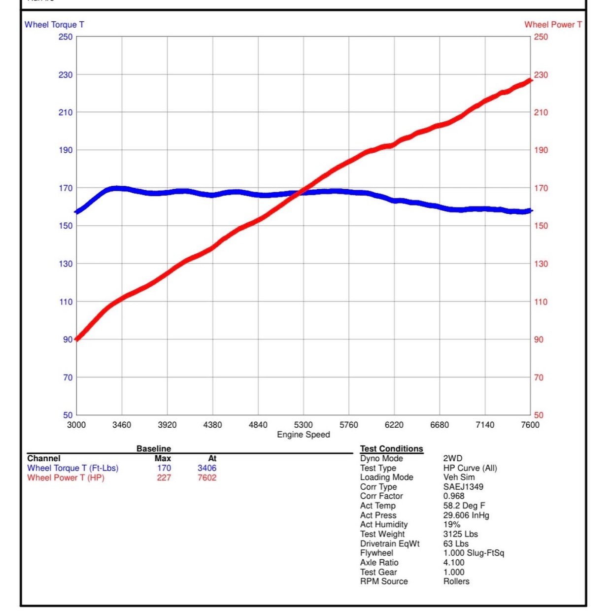

227/170
frostyfrs is offline   Reply With Quote

Originally Posted by frostyfrs View Post
On wich dyno is that
