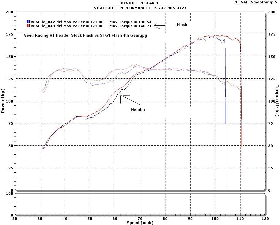

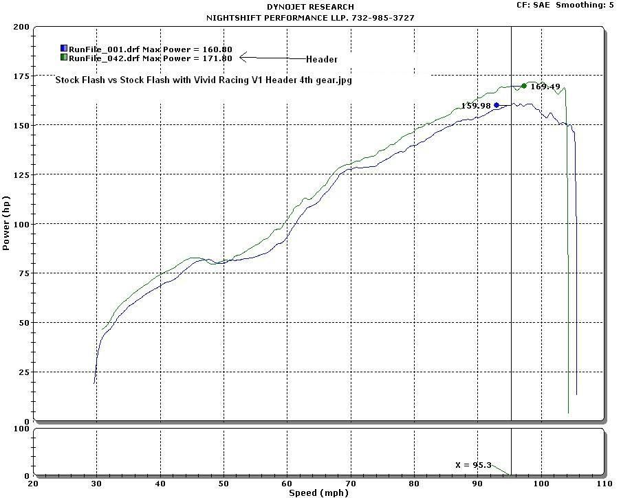

Alrighty guys - as it turns out I caught what ever my wife had last week so I'm feeling a little under the weather.
I had interesting results today.
Let me start by saying that on a DynoJet 4th gear makes 10whp more than 3rd gear!
The FRS I was working on today belongs to Prime Motoring - Thanks mike for letting me do my thing while your in Poland !
Just like the dynosheet says -
Stock Car w/ Stock Flash VS Vivid Racing V1 Header w/ Stock Flash
Looks like the header picks up great power all by itself.
Here is a surprise to me - STG1 Flash on Stock Car vs STG1 Flash w/ Vivid Racing V1 Header..
Stock car with the STG1 flash makes more power!
Finally - Vivid Racing V1 Header w/ STOCK FLASH vs Vivid Racing V1 Header w/ STG1 Flash
Discuss !
Please note I was very clear - all runs were in 4th gear.

Im disappointed that the gain from the header and the gain from the flash didn't add up together.
So now I need to find another header to test.
Then put a full exhaust on this car.
Although the flash + header might not seem worth the money right now I can say that the flash does have a lot to offer if not additional power right now.
-Higher rev limit
-More low end tq with direct injection tuning
-No longer have the crappy idle.
And when I'm finished better MPG.

I think there is a problem with that header because all the dynos we have seen thus far in the vivid thread show it gaining no power or even taking power away from the cat back or crossover pipe. Love seeing more torque in the dip. I have just noticed recently that my idle has gotten rough, with nothing on it sits at 600 rpm and kind of flutters you can see the gear shifter shake and you can feel it in your butt. Two people that have driven in my car have both asked me about it and I can't say I remember it happening a 1000 km ago or so. Has anyone else experienced the low Annoyying idle?

Just so I am reading your dyno right..... stage 1 flash with stock header is hitting 178whp?
