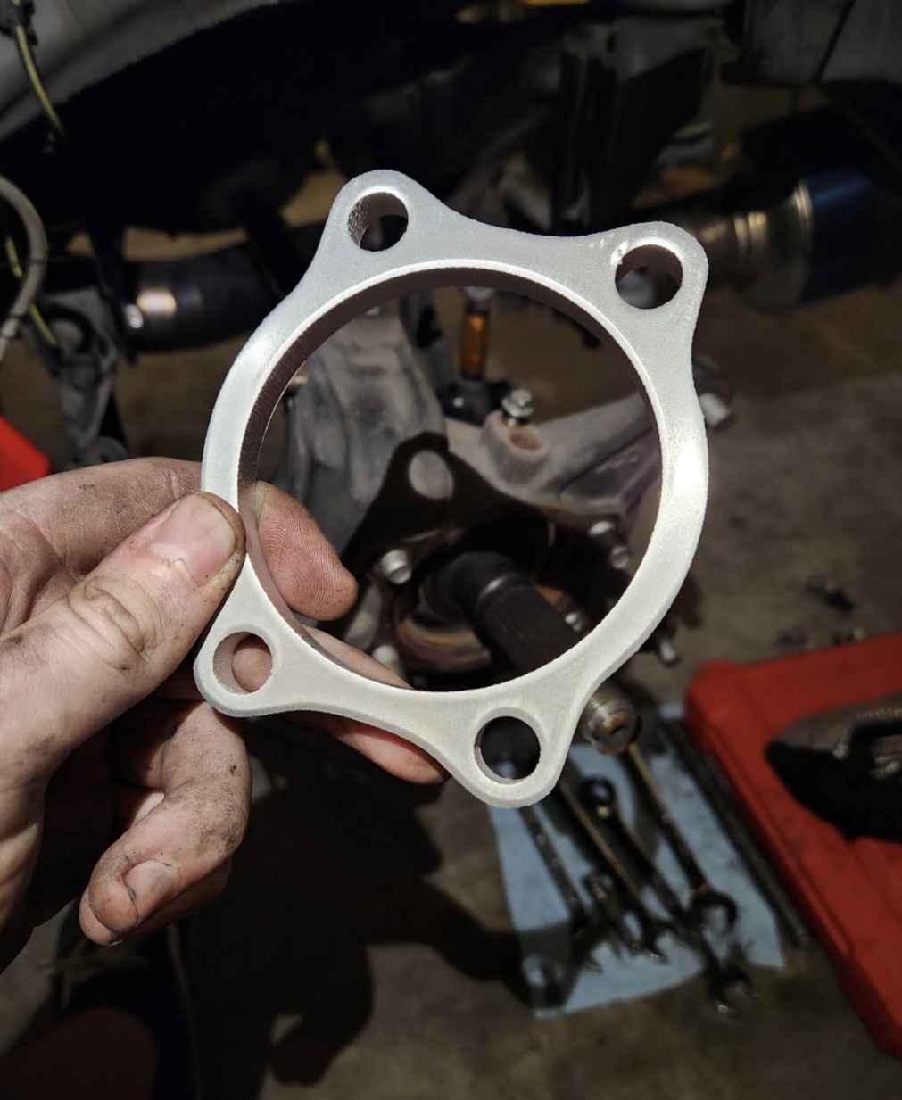

December 2022 has been a super busy month fixing and prepping the car for the NASA 2023 TT season. Parts are on order awaiting arrival and fenders and bumpers are coming out of paint ready to be bolted back onto the car.
Below are parts I have swapped out to save weight:
A1. OEM RUCA -8.7 lb (each)
A2. Racer-X RUCA +4.3 lb (each) [50% unsprung weight savings vs OEM]
A3. Wheel speed sensor brackets -0.2 lb (both)
Total unsprung weight savings = -9.0 lb
B1. Rear rotor shields -7.1 lb (both)
B2. Custom CNC cut 6061 aluminum hub shims +0.4 lb (Shouts to SendCutSend.com)
B3. Front rotor shield delete -2.0 (both)
Total unsprung weight savings = -8.7 lb

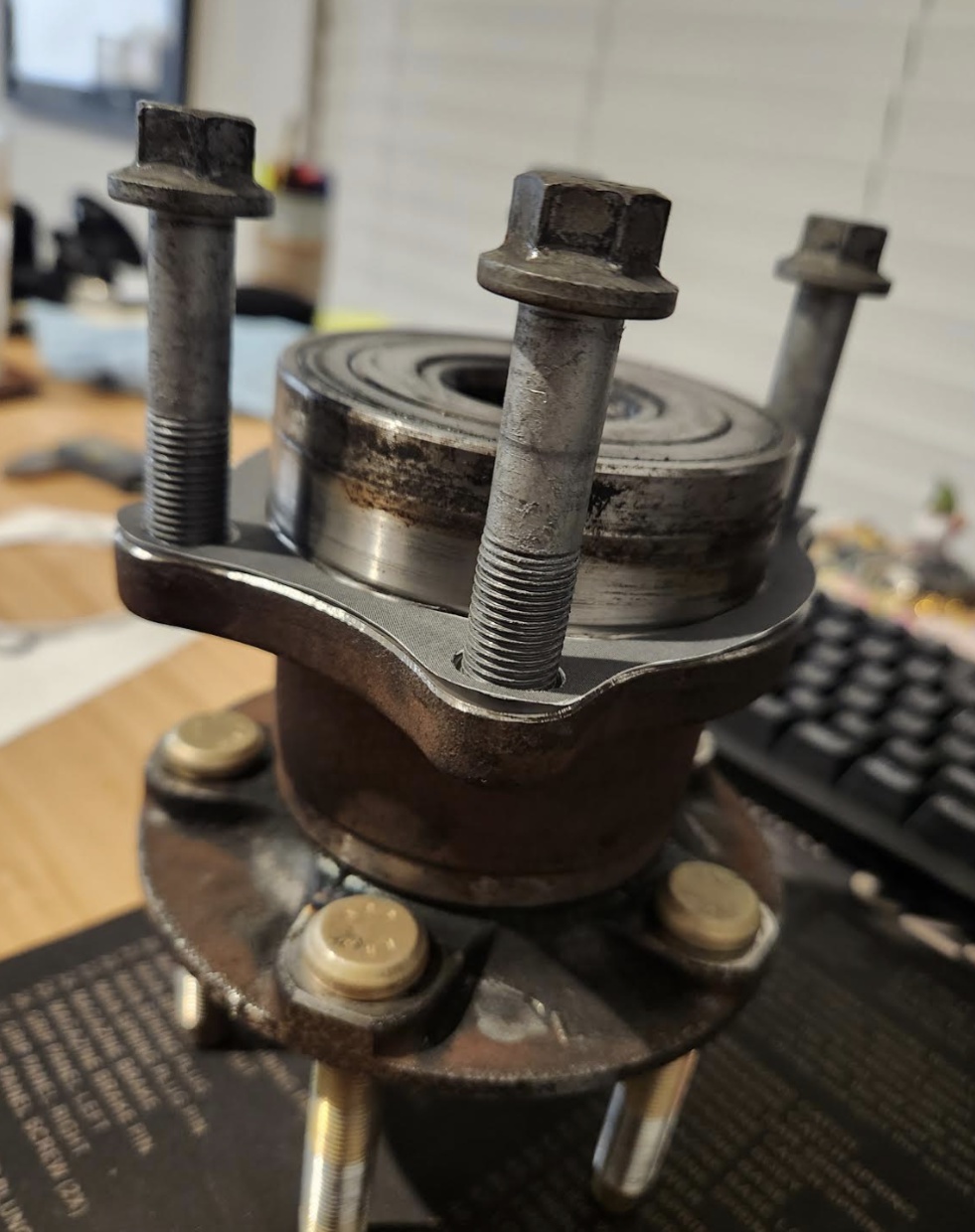

Old 12-16-2022, 08:49 PM   #26
Nick Dugdale
Nick Dugdale's Avatar
Join Date: Dec 2021
Drives: 2015 Subaru BRZ
Location: South East Region
Posts: 38
Thanks: 35
Thanked 83 Times in 30 Posts
Rear brake rotor shield delete must be swapped for a similar thickness 'shim plate' in order to maintain adequate distance for the wheel speed sensor to recognize / read the magnetic servo axial ring on the wheel hub.
I made sure to dial in all necessary caliper measurements before creating a oil negative photo of the flange surface. Once I peeled off a negative photo using paper and used oil, I scanned the image into Adobe Ai and went to work rendering out a vector file of the shim exactly to spec. I connected with Send Cut Send to have the shims laser cut from '6061 aluminum' to maintain strength and corrosion resistance while keeping things light.
• The OEM rear rotor shields weigh (~3.60 lb each)
• The CNC cut shims weigh (~0.19 lb each)
• Total savings of (~6.80 lb unsprung weight)
Huge unsprung weight savings off the rear suspension. My vector designed shims came out looking fire.
"The vision manifests the reality." NASA TT5 Silver 2015 Subaru BRZ Limited
Nick Dugdale is offline   Reply With Quote

Old 12-17-2022, 12:01 PM   #27
blsfrs
blsfrs's Avatar
Join Date: Dec 2018
Drives: 2013 frs base
Location: central Virginia
Posts: 1,448
Thanks: 2,722
Thanked 1,463 Times in 691 Posts
Those shims look awesome. In the picture, they look much thicker than what I would imagine the thickness of the original shield would be.
blsfrs is offline   Reply With Quote
The Following User Says Thank You to blsfrs For This Useful Post:
Nick Dugdale (12-17-2022)
Old 12-17-2022, 12:17 PM   #28
Nick Dugdale
Join Date: Dec 2021
Posts: 38
Thanks: 35
Appreciate it. These shims are in spec with OEM shields down to the thousandths.
