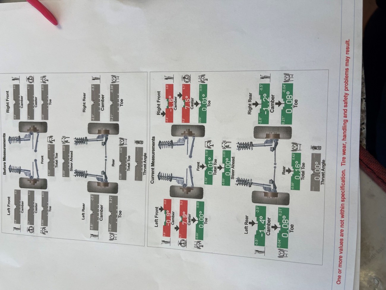

specs before specialty shop
mod on

1. It seems that even though I have all these adjustable parts the camber cant be put to oe specs. Not that im going to leave the camber at 0 degrees or -1, but my worry is that if I cannot adjust to oe that there is something wrong with the install.
2. The car is daily driven with some track and autox, I went with aftermarket tie rods after reading am article that Moto miwa posted talking about how after 5 years regardless of miles a person should swap them out to keep the steering wheel feeling tight. With that said I opted to go with an upgrade instead of keeping the oe.
3. Ya I know, but I wanna do it right.
4. I have the car at Chewerks right now, hopefully they get it back to me in better shape.
thanks for the quick response btw. Any input on the end link length, was looking everywhere for info and found nothing.
1. Forget OE specs, your car is far from OE now.
2. Aftermarket isn't always an upgrade. Those parts aren't necessarily bad but they're adding complexity that you don't need. They won't last as long as OE.
3. Understandable. Corner balancing is nice to have.
For endlinks, you want the studs to just line up with the mounting holes with the car on the ground. So don't set them with the car in the air.
Originally Posted by ric342 View Post
This is not the final alignment right? Front is not good.
- Andrew

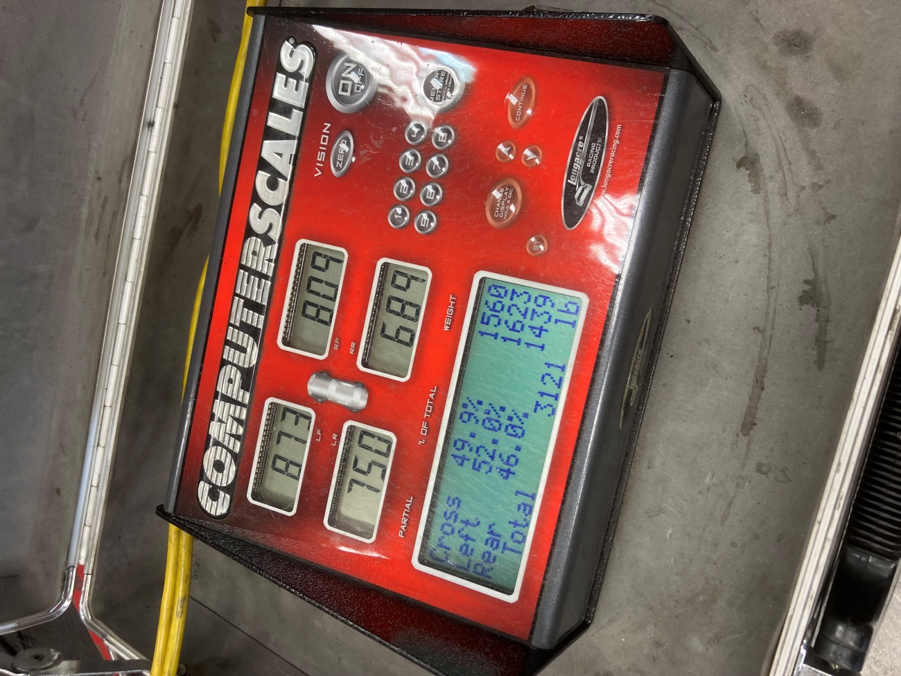

aligned and corner balanced
final specsName:  3333333.jpg

Old 10-02-2022, 12:49 PM   #4255
Racecomp Engineering
Location: Severn, MD
Posts: 5,520
Thanks: 3,542
Thanked 7,416 Times in 3,034 Posts
Mentioned: 311 Post(s)
That should be fun.
- Andrew
